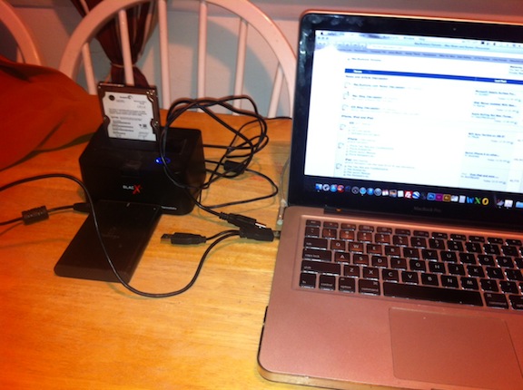

Yes it can be removed and I am working on it now, Thanks!

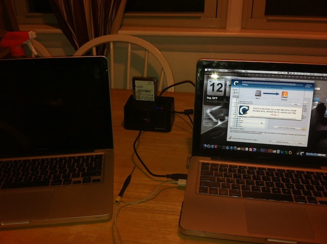

So far so good, drive mounted and I copied some personal folders over then used migration assistant for the applications etc...
Added a partition on my drive with a fresh OSX install so I could get his stuff there.
Now doing a CCC and hopefully all is good
