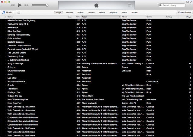

A while ago I tried to install a custom theme on my iMac running Lion 10.7.5. After discovering that it didn't work, I deleted the files and left everything alone. A few days later, I open iTunes to find this:
I tried to look for the files that I had edited, but can't find it anywhere. Not even the back up copy that I had made. Whenever I connect my or my wife's iPhones, I cannot tell what I'm doing as the text is black on a black background. If anyone can tell me how to fix this, I would be immensely grateful!

Quit iTunes, then Open Terminal and type:
Code:
defaults write com.apple.iTunes high-contrast-mode-enable -bool FALSE
If that doesn't work, Quit iTunes and re-run the iTunes installer: http://www.apple.com/itunes/download/
If that still doesn't work Quit iTunes, Move iTunes to the Trash, Restart and then re-install iTunes. After its re-installed Repair Disk Permissions (Disk Utility > Click Macintosh HD > Click Repair Disk Permissions)
Note: If everything is working, you can go ahead and empty the trash when your done.

It was in high contrast mode. Thank you so much for your help! I really appreciate the speedy reply! If I have any other problems with this I will post it here.
