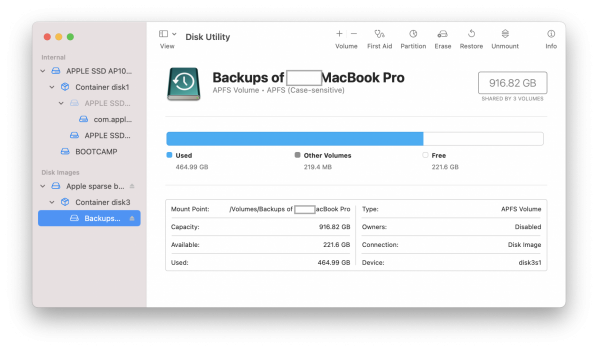

After upgrading to Monterey from Big Sur I found out that one of the software doesn't work with the new version. So I figured no big deal, I'll just rollback and wait a while, I expect the new system to be pretty buggy anyway. So I went into the Recovery Mode and tried to restore back to Big Sur from a local snapshot. But it turned out that you can't restore to older system versions, it only restores your files (aren't the system just files too?). Then I have to do a full disk restore from my Time Machine backup. That didn't work either, Because since Big Sur they stopped letting you do that, instead you're forced to use the Migration Assistant. I got really annoyed, I don't want to install a new copy of Big Sur and pour my files all over it, I just want my old system back.
So it's not the first time I've encountered this. Last time, in early Big Sur days I worked around this by using a pre-Big Sur Recovery Mode and a full disk restore will work. So then I wiped the partition, and used the internet recovery, which downloaded me a Mojave Recovery mode. I went in with the options to restore. There were few visual glitches but I was able to navigate to the backup...which are all blank boxes. I select the top one assuming it was the newest. I wasn't too worried because there were visual glitches last time too iirc.
And then everything went wrong. The restore had no moving progress bar and only took minutes, then it prompted to restart, which then it restarts into nothing, and it goes back to internet recovery. I started panicking, and installed a new copy of Big Sur and went in to check if the backups are ok...they were not.

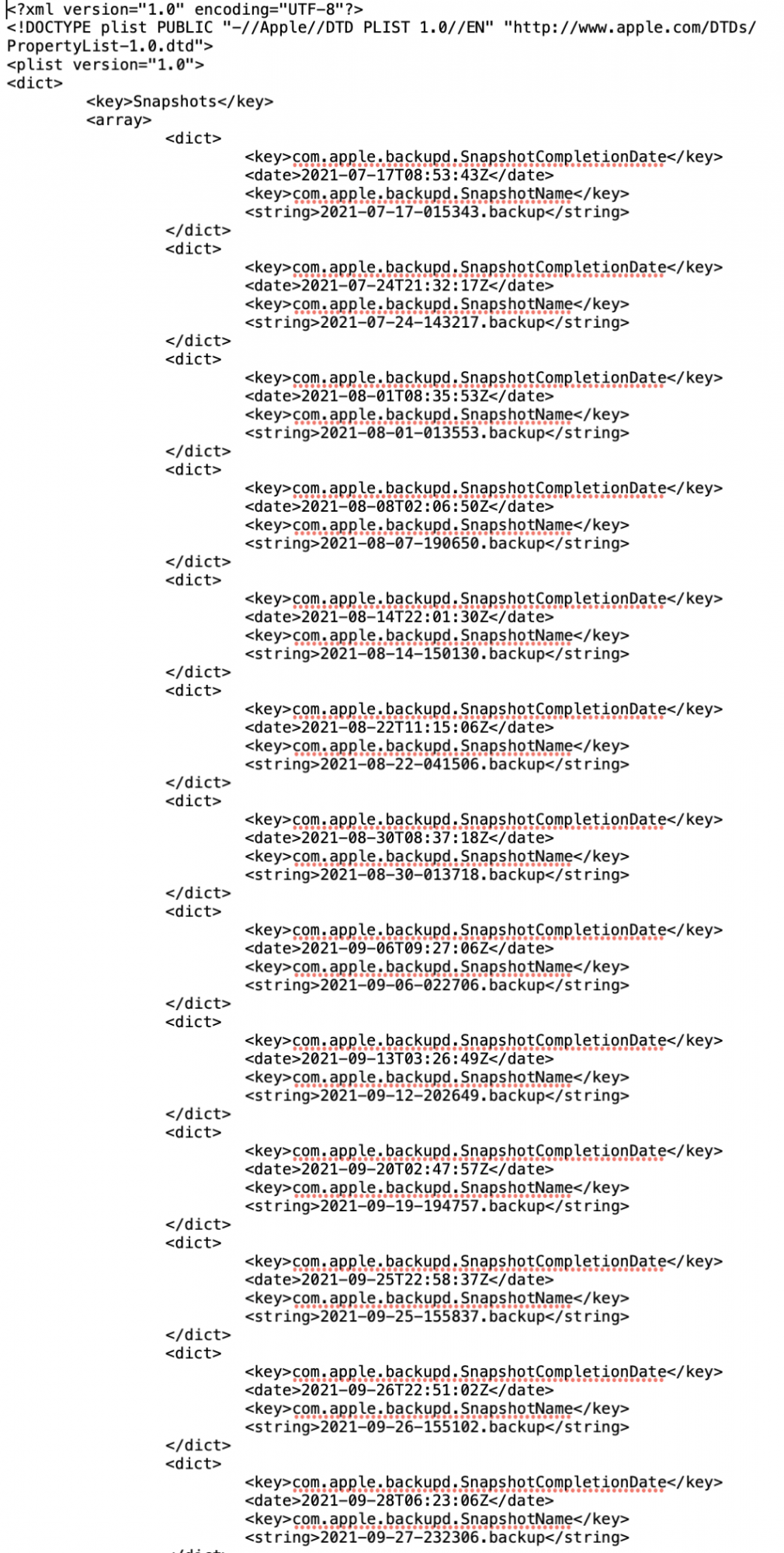

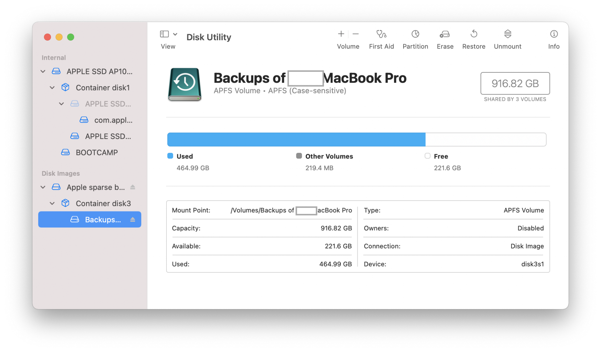

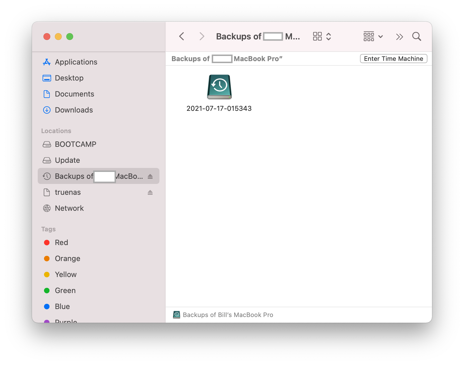

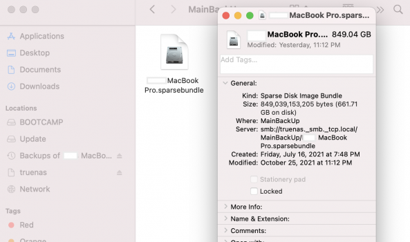

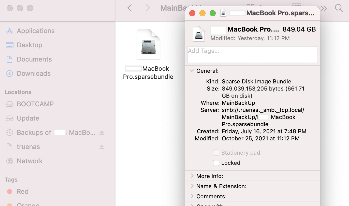

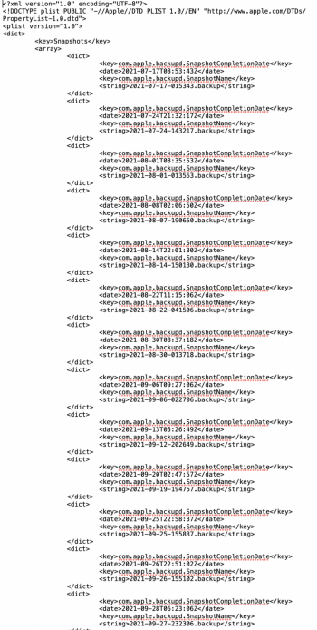

The only backup I am able to see is from 3 months ago, which was the initial backup, everything after that is gone. The disk usage is still there. I have the Time Machine backup on a NAS. I can see the sparsebundle's content is solid, but the backups are missing after mounted it on.
Help me brothers I really don't know what to do now.
