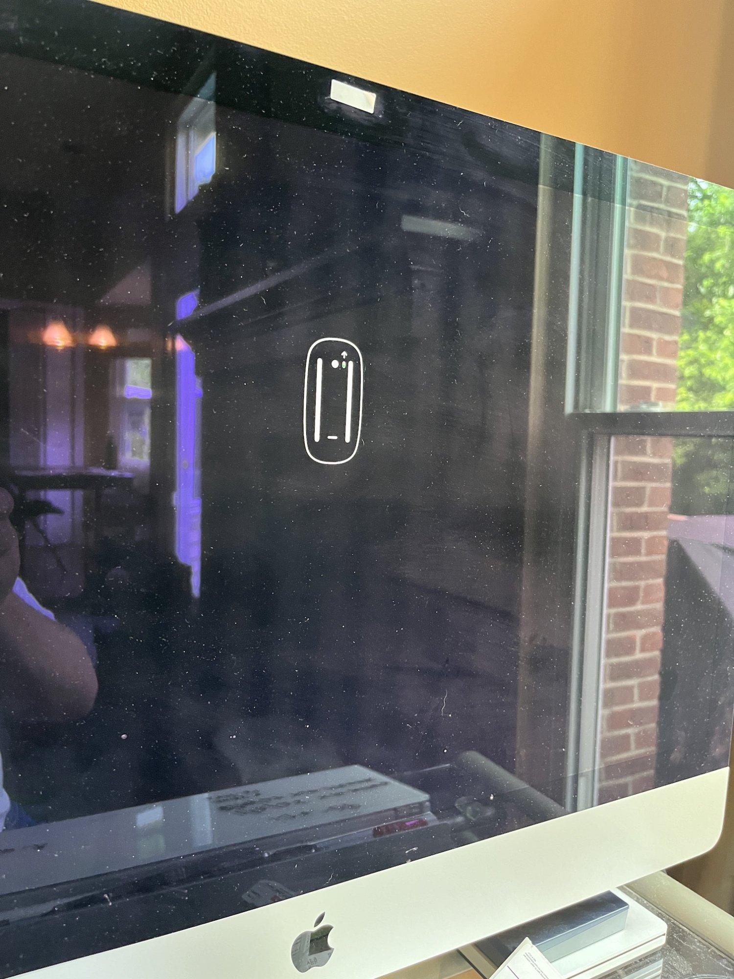

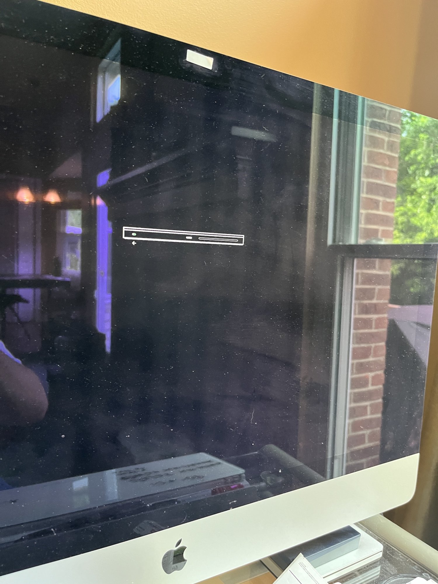

When I try to boot my iMac into recovery mode it just goes to the following two screens. I am trying to make a bootable external disk. Can I use internet recovery to do this?

Yes. Or Apple brand Bluetooth keyboard and mouse.
My keyboard is the Apple keyboard that came with the iMac, the mouse is a Logitech. I will try to find the Apple mouse and give it a try. If not a wired keyboard and mouse is cheap.

I am using a Samsung T7 Touch SSD and running BigSur. I tried making a bootable disk with SuperDuper but it did not seem to work for me. I was able to access Recovery Mode using an Apple trackpad and was able to create a bootable disk.
