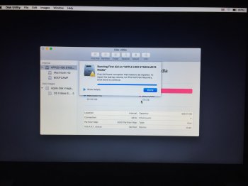

In Recovery OS, Disk Utility has found corruption from its First Aid scan, but it says it can only be resolved in Recovery. The problem is, it was already in Recovery. The same thing appears when I run First Aid in Safe Boot, or normal boot. I've attached a picture of the message that appears.
I'm running macOS Sierra PB 2.
UPDATE:
I might be wrong, but this corruption appears to be putting my Mac into a state where it nearly always crashes, so I need solutions ASAP please!

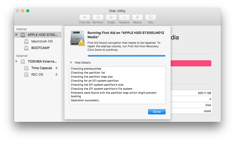

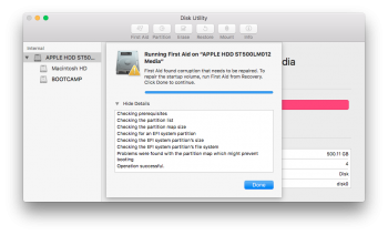

Not sure this is going to be of much help, as it says something about a success!
The second screen shot does not appear to have been run from the recovery partition as the recovery partition does not appear in the disk utility window.

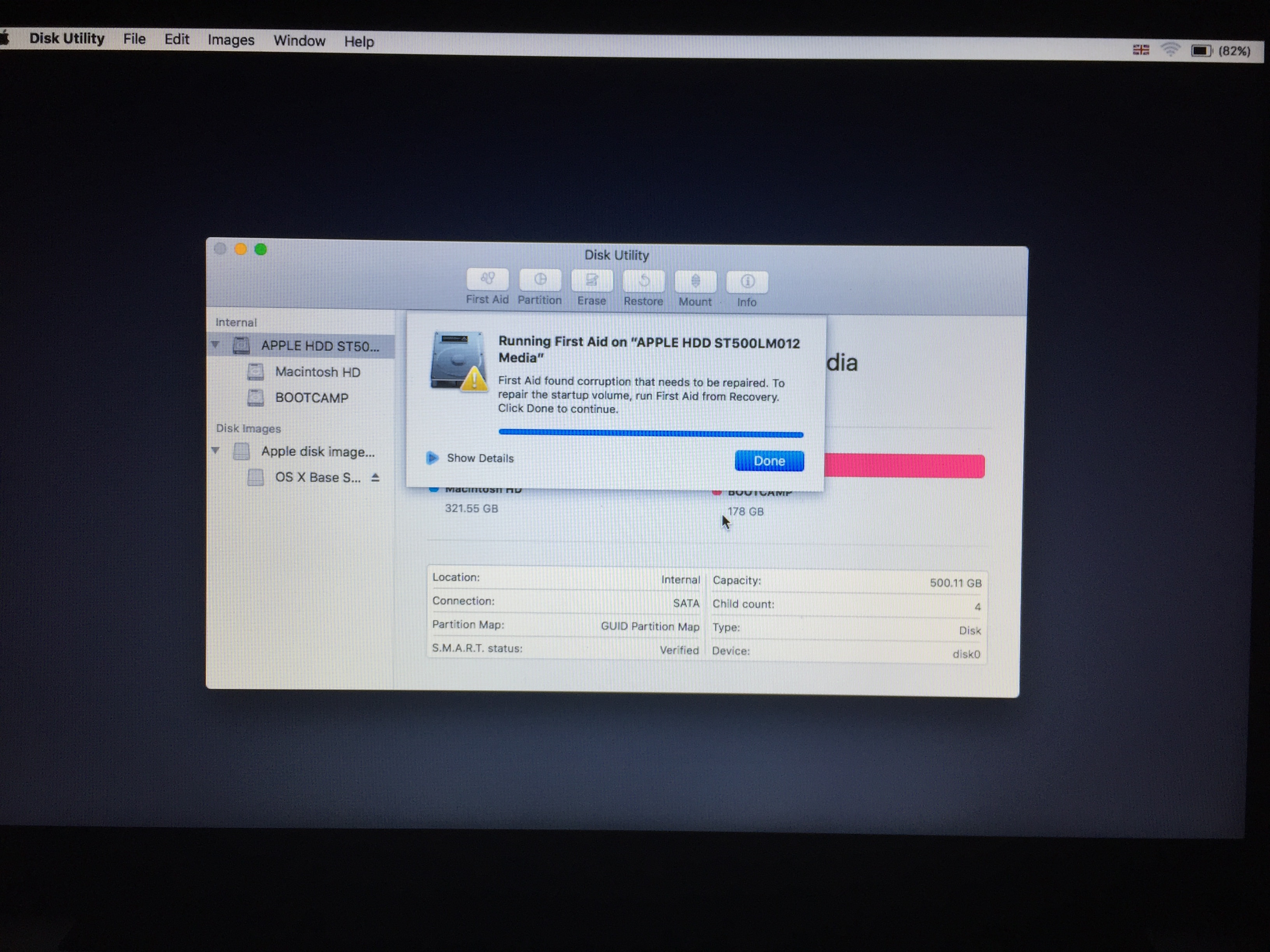

UPDATE:
Since the external boot didn't work, I tried doing Internet Recovery, which produced a huge list of information, (like, really huge. OS X Mavericks Disk Utility was much better, let's face it). However, after clicking "Repair Disk", it did a load of tasks, then said "Alert. This disk needs to be repaired. Click Repair Disk.". I did that a few times, then gave up. I tried to copy the logs to a Google Drive through the "Access help online" thing, but it froze so I had to do a manual shutdown. Upon boot I was greeted by a lovely flashing folder with a question mark on it, which stayed there. I checked it out on my phone, and official Apple Support said to power off, then boot to recovery, and use the "Choose startup disk" feature. That produced the same result, so I gave up, erased the disk, and reinstalled macOS. Checking Disk Utility now produces totally clean results.
