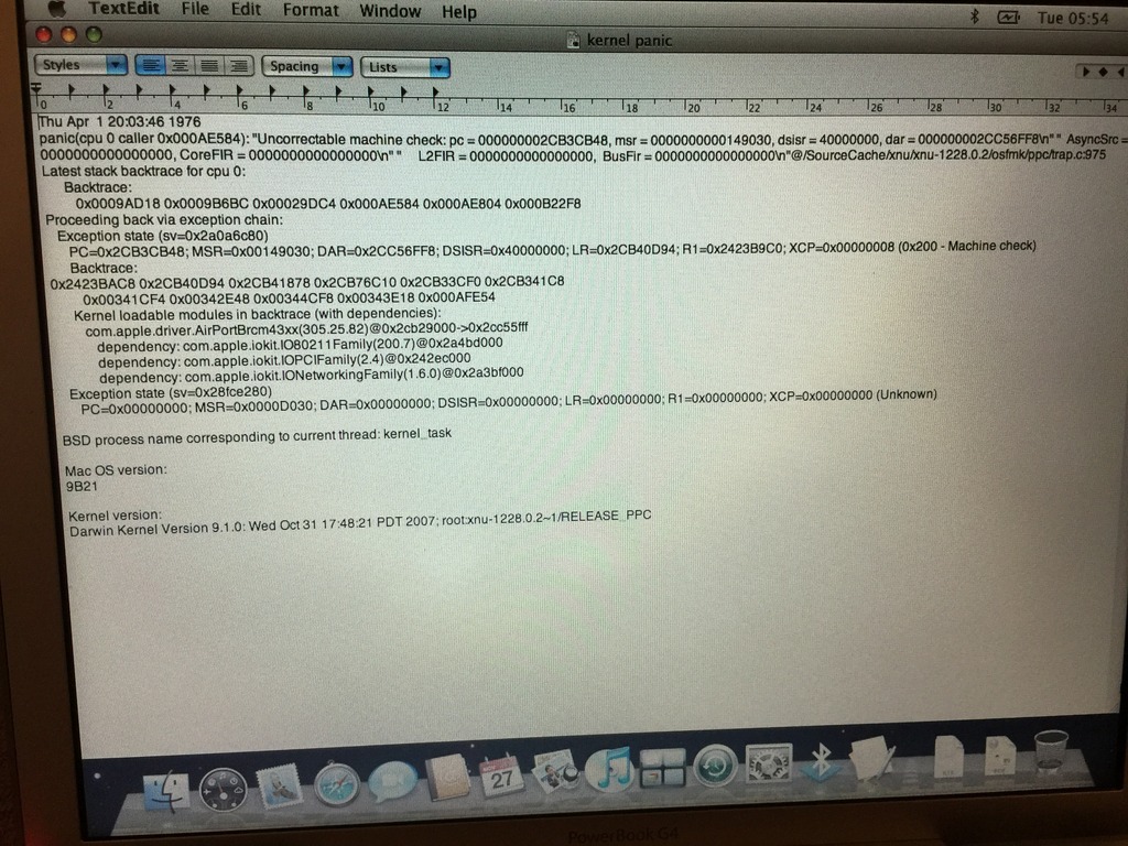

I've been having an issue with my 2006 PowerBook G4. It will not boot without kernel panicking within the first few seconds after chiming. It has been doing this for about a year and started suddenly, however it's been in my wardrobe gathering dust until then. I have wiped the hard drive thanks to using a Leopard install disc, so it's a completely fresh install. It didn't change anything and the panics kept happening. Booting into Safe Mode stops the kernel panics, meaning it's probably something to do with the start up process that prevents the PowerBook from booting normally.
Here is the log:
IMG_6973_zpsnutktvt3.jpg.html
Your screen shot seems to indicate a problem with the drivers for the airport card, so you may possibly have a hardware issue.
Do you have a hardware test CD? If so, try booting to that, and run the hardware test.
The OS X version showing on your screen shot looks a little odd
"9B21" would be an intermediate version of 10.5.1 - maybe from a grey DVD, and not from a black commercial Apple installer DVD.
Try downloading the current 10.5.8 combined updater. You can get that using a different Mac from here. You can transfer that to a flash drive.
Can you boot to safe boot mode (restart, holding the shift key)?
If you can stay working then, try to install that combo update. It can take a LONG time to complete (30 minutes to an hour), but may get you going again, assuming some software issue with the version of Leopard that you have installed now.

In safe mode disable your Airport drivers (kext files).
Your Airport Extreme card has probably failed. Disabling the kext files should allow the Mac to boot normally.
I unfortunately don't have a hardware test CD. Is it possible to replace card?
You can diable the kexts. Just move them out of their current location to a folder elsewhere. If they don't load when the Mac boots the Mac won't KP.
You'll have to Google where they are, I don't recall offhand. Not sure if you can replace the card but I would think so.

Excellent, I'll do this.
Just keep in mind that disabling them disables the Airport card, so there won't be any wireless connections.
OK. The card is removable - do you think that a loose connection would cause the Mac to kernel panic? Could I find a new or used internal card on eBay?
It's possible a loose connection is the problem. You can try reseating it.
Replacements can always be found on eBay. Should be fairly inexpensive I think.
I would just replace it. The PowerBook is 11 years old, which means the Airport Card is also 11 years old. Parts fail and being stored in a closet doesn't impart protection from that.

Some 12" powerbooks had a little piece of plastic glued in behind the airport card from the factory. I guess that was their fix. I'd guess it slipped out of place. You could pull it, see if the problem goes away, then put it back in. Or maybe if you look it will be clearly out of position. Good luck.

Then just reboot.
I suspect your logicboard is the ultimate problem.
I had a similar problem on my 12" iBook (it's a common issue). I removed the built in Airport Extreme card but it still had kernal panic, the solution was to remove the kexts from the iBook in target disk mode from another Mac.
For Wifi I now use an inexpensive USB miniature dongle which has it's own drivers and causes no problems.
Which USB dongle did you buy? I imagine no new ones will have drivers for Leopard? I suspect this to be the necessary workaround.
I used this which has drivers from 10.4 to 10.9:
https://www.amazon.co.uk/Neotechs®-802-11N-150Mbps-WIRELESS-ADAPTER/dp/B004XZEGQW
Doesn't seem available now (I got my last one a year ago) - I'm sure you can get similar under a different brand, just check with company for available drivers.
EDIT: Might be worth a look....
https://www.amazon.co.uk/Edimax-EW-...coding=UTF8&psc=1&refRID=PR2EH98QVXVV2JSB6QZN
http://www.edimax.us/html/english/frames/b-download.htm
As said, the common mode of failure has to do with the interaction between the LoBo and airport card. Replacing the airport card has never fixed this that I've seen.
You're best to nuke the kexts as others have suggested.
What's the reason for removing the kext files? Is it necessary to keep the airport card inside the machine?
The reason for removing the kext files is so that the drivers do not load.
If the drivers load the Mac bombs.
You can try removing the card, but if the drivers still load and the Mac bombs then you know this is still your problem.
I sense a serious aversion to removing the kext files on your part, despite all the advice to do so.
Is there any specific reason you have to explain why your allergy to doing this is so serious?
Not at all, I was just failing to see the point when removing my Airport card does the same thing as removing the kext files, as when I remove the card the machine stops kernel panic-ing. It must be a problem with the contacts inside the AirPort slot.
