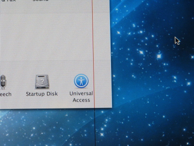

My screen is displaying a red vertical line. It goes from top to bottom. I did a screen capture but it does not show up. Is there a cure for this?

It's a panel or display cable fault. Probably the panel.
^^^This.
And once it starts, it will only get worse. The line will get wider and you will get more lines. You can replace the LVDS cable, but it's a pain and the chances are that it's NOT the cable. You won't know until after you've done all the work. Replacing the LCD itself is not difficult, just a lot of steps.
Tough decision now. Is it worth it to try and fix. It is a 17" Apple Studio monitor. I opened it up and checked the cable connectors and they all look secure. I guess I will use it until it bothers me to h@ll and then move it to the spare parts pile. I did however find a nice space wallpaper that hides it pretty well until I open up a program. arghh..
