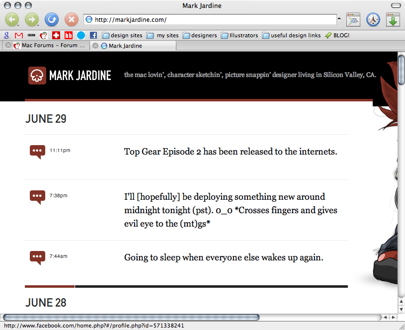

That's such a nice site! So is your portfolio one. But it might be a bit too wide for some people.
As per lofight I'd say width is an issue and that the typesize for entries could be taken down a notch or two to solve this.
Yea the width was a conscious design choice that I made and won't be correcting because everything is on a grid. I'm totally aware that some will have to resize their browser to see everything, but I'm fine with that. 😀
Nice enough site for sure but the width thing is irritating , why would you not 'fix' this so folks who see the site on smaller screens can see it without scrolling side to side 😕

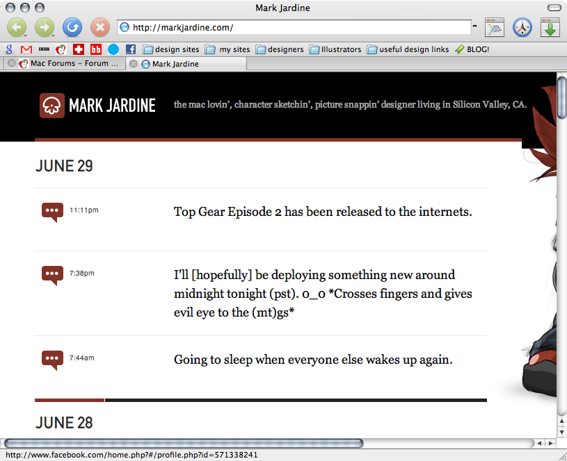

What size/res is your display? The site width is 1150px (actual content within 1050px) which is not too wide unless you are running at 1024x768 or below. I can view the whole page fine on my macbook air with plenty of extra space. Also, about 90% of users who visit my site have resolutions above 1024x768. 🙂 Remember, this isn't a corporate site. It's basically my personal playground to experiment as well as tell a little about myself. But if everyone who replies in this thread comments about the width, I might consider it as being a more serious issue. 😛
This is how it looks on a 12" iBook (1024x768), with a non-maximised window. I can get frustrated by sites being too wide, but as the main content fits in the browser and you only have to scroll to see the secondary content, I think it works well. It's not as if you have to scroll sideways constantly to read the content.
Also, as it's a personal site and most of your visitors have wider screens I would say it was less of an issue than a commercial site, too.

Well yeah. But not everyone who has above 1024 px wide display used their browser on full width. I keep my browser on 1000 px wide from the 1440..
Looking good! (Although I've always liked your work 😀).
Thanks. 🙂 Yea even though it breaks, you can still read content without side scrolling.
But, this whole width discussion has given me an idea. I'll [attempt to] create a smaller grid layout for smaller widths and have it auto-switch layouts based on your browser width. That way everyone is happy. 😎 I really appreciate the feedback. Personally, I've never been bothered by varying website widths. I just hit the zoom button. But I guess I'm in the minority. 🙂
That sounds like a good plan if it could work. I wonder if one way to make it work would be to reduce the text size on the smaller width one. I know it's a design feature, but then I know I sit much closer to my 12" screen than I do my 24", so you could preserve that large bold text look on a smaller width even if you knocked it down a point or two.
