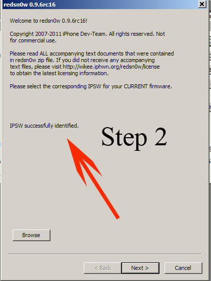

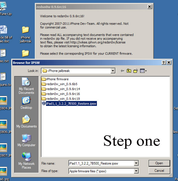

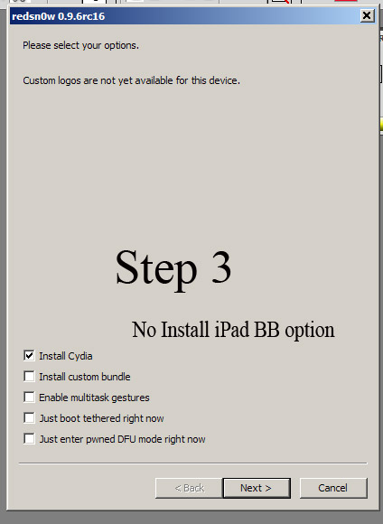

Hi Crystal,
Here are the screenshots I was telling you about.

Hi Crystal,
You did it wrong.
1. step 1 is to point it to 4.2.1 firmware which is the fw you have on your phone.
2. step 2 is to click on "Install ipad baseband" 3rd box down. You don't need to do anything with ipad 1,1 3.2.2 firmware, you just need to have it on your computer so redsn0w can locate it and flash its baseband onto your phone.
3. follow direction.
Let us know your progress.
