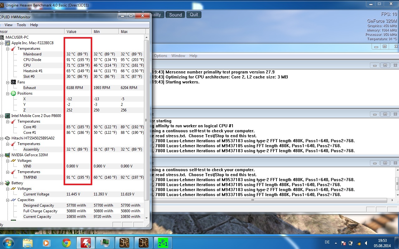

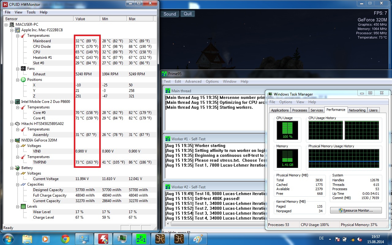

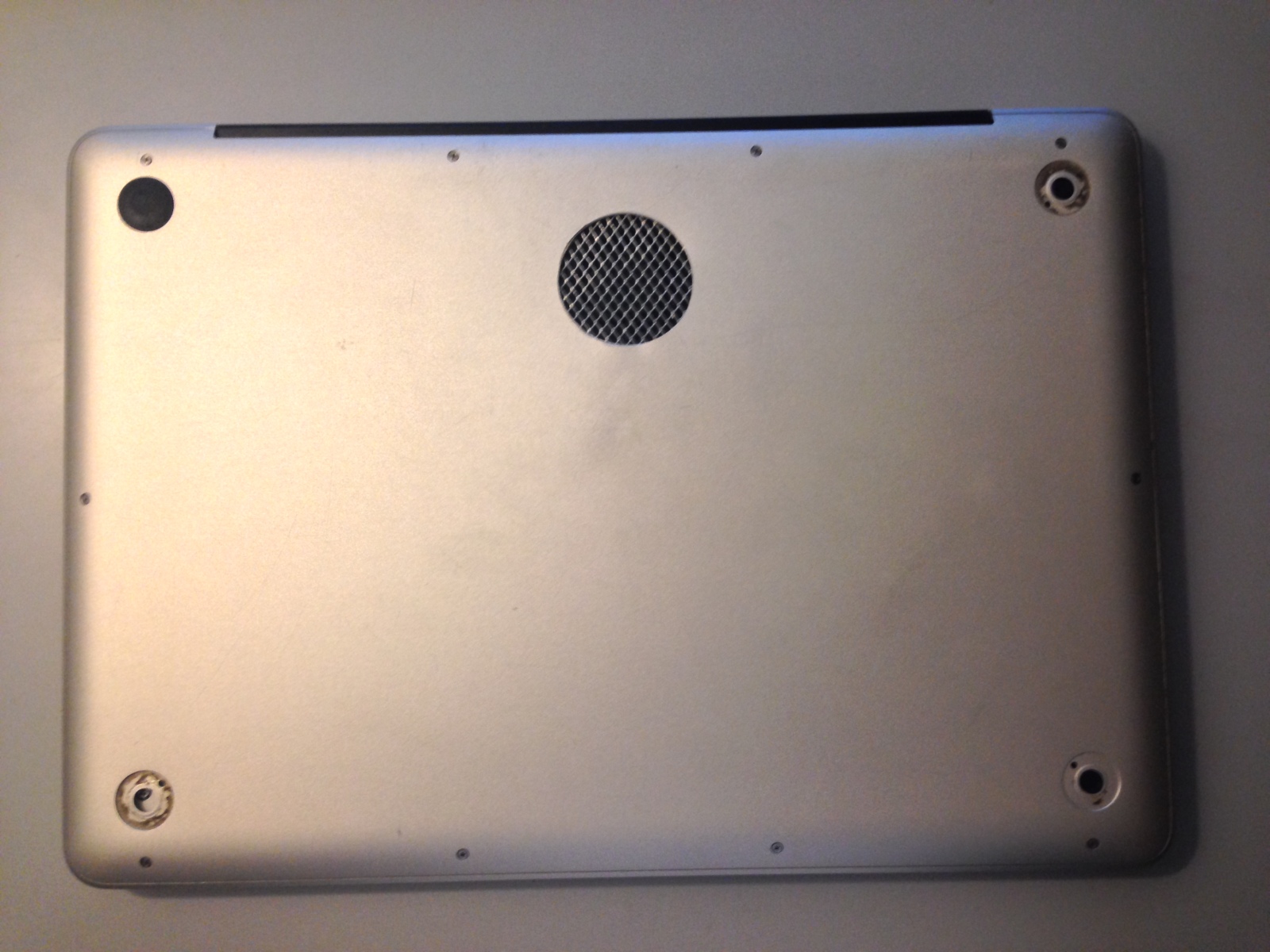

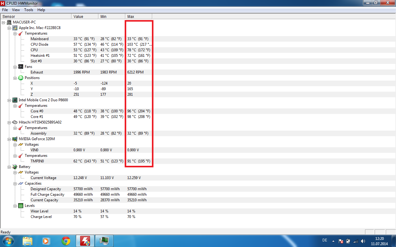

Hi everyone, my gf had some heat problems with her macbook pro so i decided to deal with it and i came out with a little effective mod. To get started i changed the thermal paste with the mx-4 which dropped the temps 8-10c, after that i still wasn't satisfied and ran some benchmarks on the laptop without the back cover and noticed a huge temperature drop. So, i drilled a 4cm hole above the fan and put a grid on it. The Downside of the mod is that you have to clean your laptop more often like once every 3 months, the reason is the obvious dust accumulation. If you are lazy or have no time to clean the dust out, you can just use the vacuum cleaner or whatever you want to clean it. Anyway i used prime95 and heaven benchmark to pump up the temperatures. Vacuum isn't the best way to clean your laptop, is the lazy way to do it. Thx people to keep repeating it 😎
this is how it looks

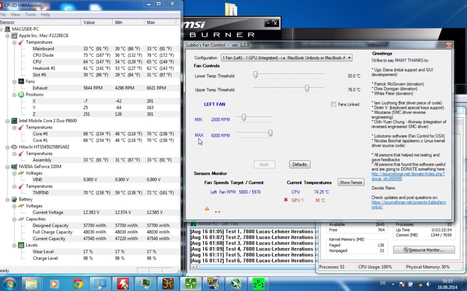

and now the temperatures, funny thing the fan wont spin up until the temps reaches 85-90c then it lowers down to 70. to prevent this im using lubbos fan control with 2000-6000 rpm and a 76c threshold.

mod+fan control+max oc on the gpu with msi afterburner
stock temperatures, cpu: 98c gpu 91c
mx4+mod+fan control+gpu oc, 70c on cpu and 72c on gpu.

Big problem with this is that you have undoubtably altered the airflow path within the laptop, mostly what I would expect you have done is improve airflow to the cpu but it may have reduced airflow over other components that don't have temp sensors and are now at more risk of unknown heat stress and earlier failure.

well i put under stress test everything for a half an hour, and the laser thermometer i borrow from my neighbor didn't show nothing unusual on other components like battery and different areas of the mbp. usually i don't like the feeling of my legs burning off while using a laptop lol.
