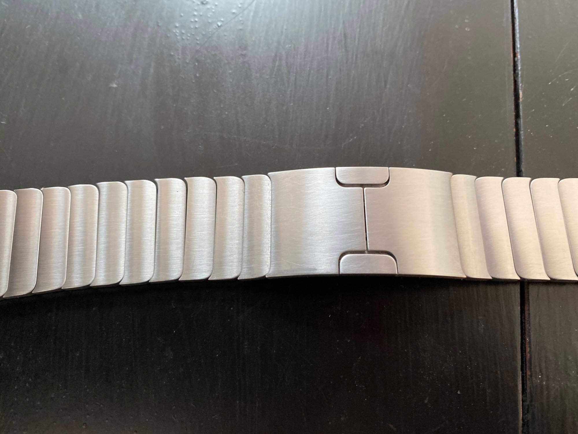

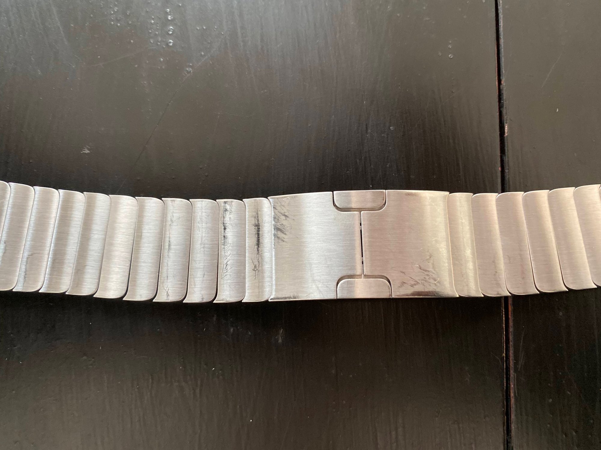

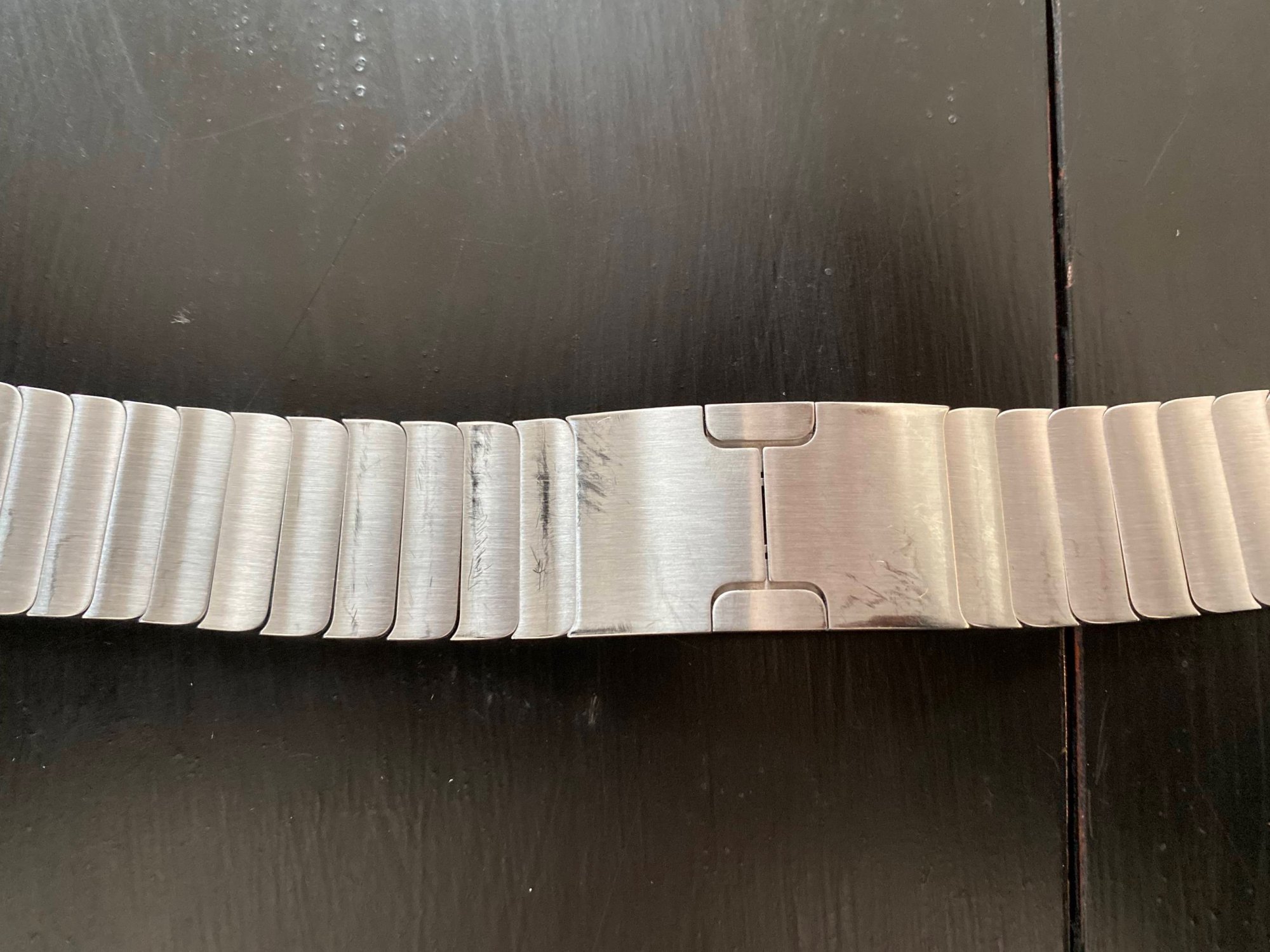

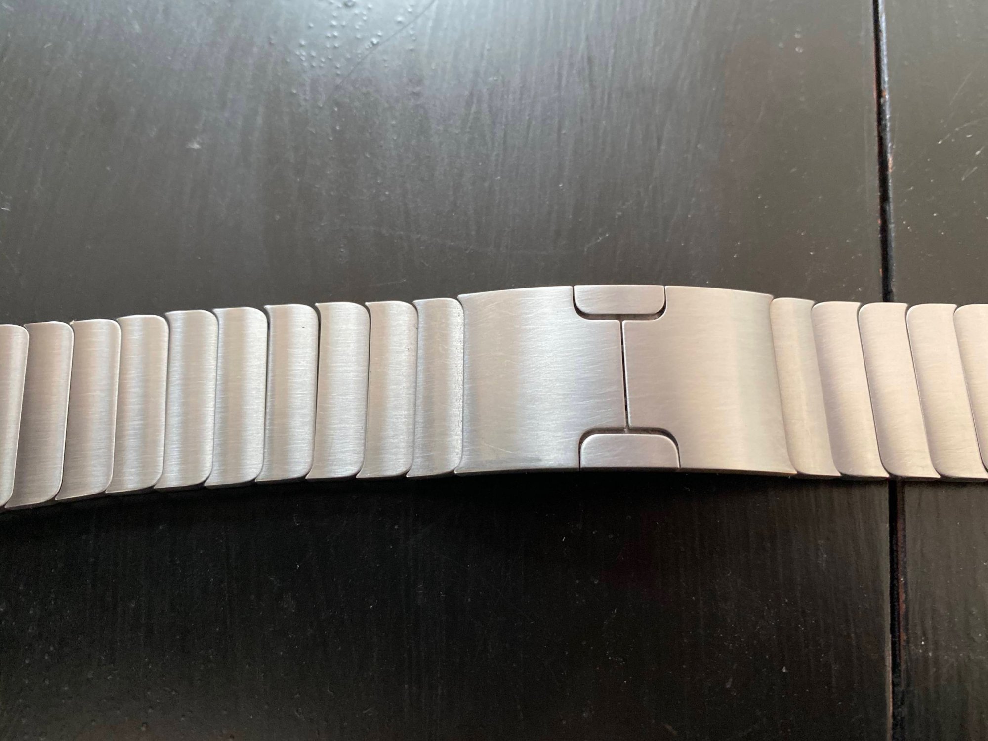

I've always appreciated the Apple Link Bracelet and have owned mine for 3 years now. Its my favorite watch band and the one I wear to work every day and I think its the classiest watch band that Apple makes. I decided to see if I could take a refinishing pad and put the original brushed look back on the watch and wow what a difference. Really easy to do if you want the original finish back on the bracelet. This is different than using a cape cod polishing cloth as those remove the brushed finish of the band and give it more of a shiny chrome look, which isn't what I wanted.
Here are a couple of before and after photos. I'm really happy how this turned out and it looks like it just came out of the box.

View attachment 960146View attachment 960145

Link is above. When needed, you just gently brush the bracelet with the pad. Any scrapes will blend right in and it will look brand new after just a few minutes.

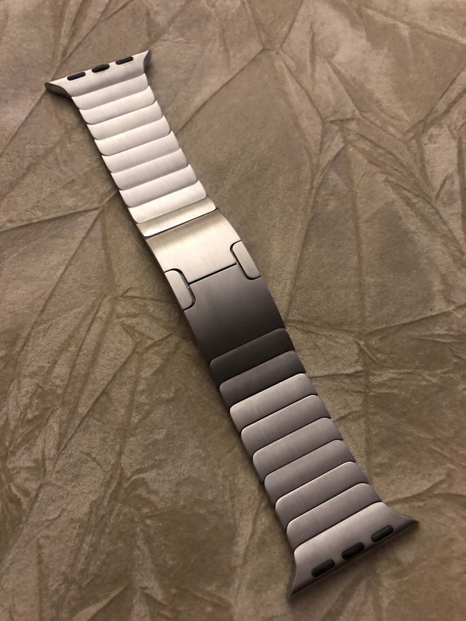

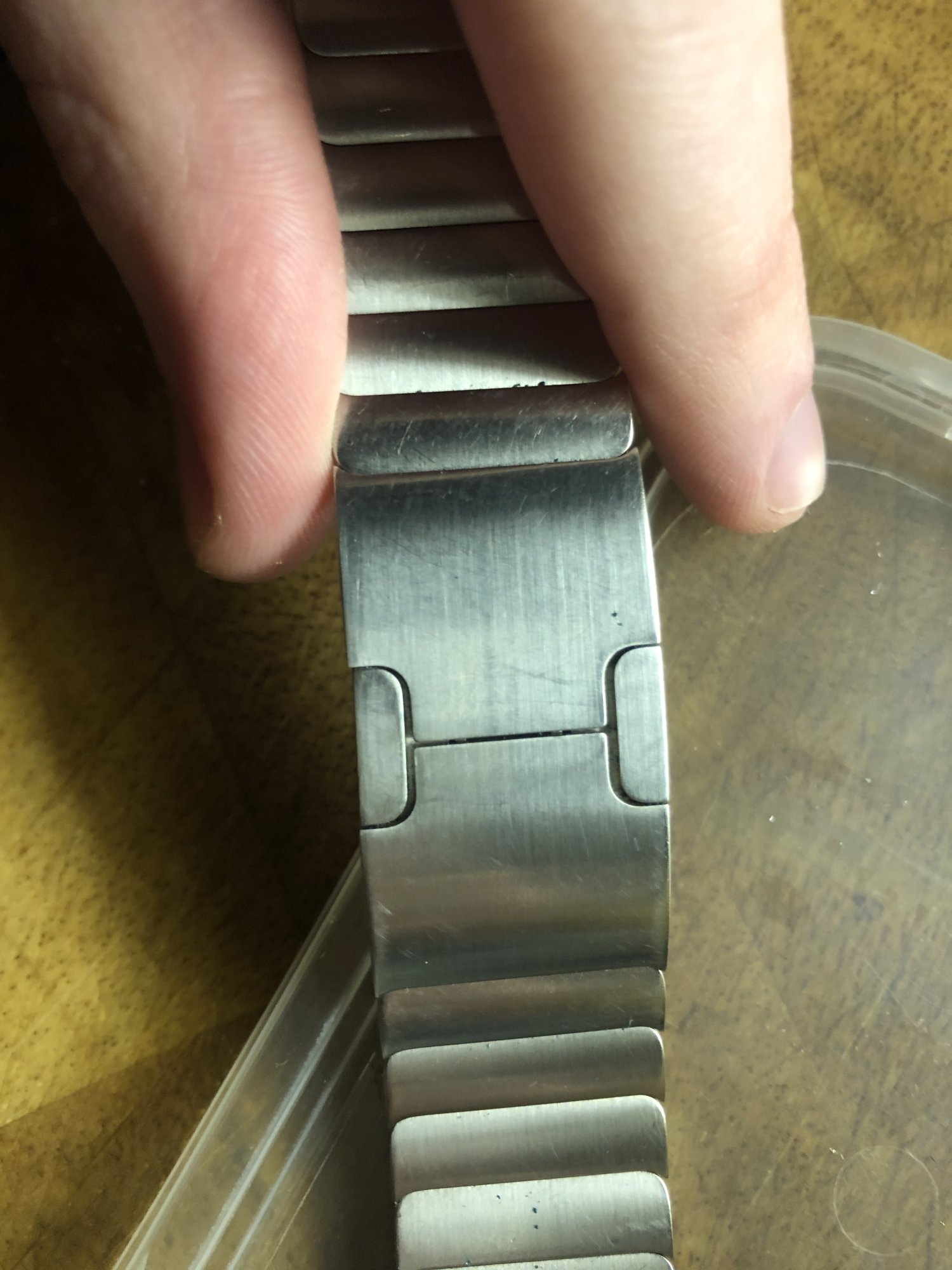

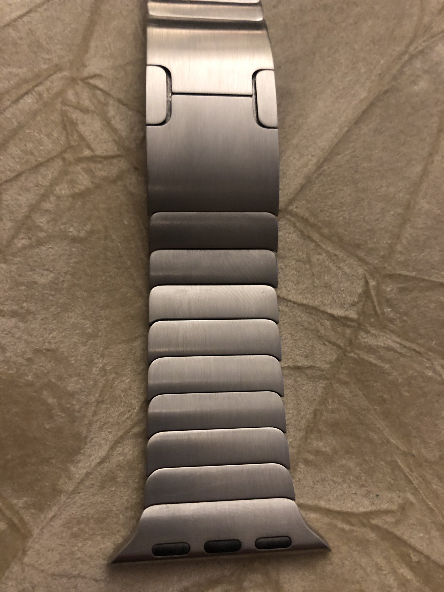

I have an SS Link Bracelet purchased in late 2015 (not long after buying the first model of Apple Watch) that I have kept looking new by refinishing in a similar manner. But I use a Scotch Brite green scouring pad. These are readily available in hardware stores. Some recommend the grey pad, which is a finer abrasive, but I've been happier with the scratch removal performance of the green pads. My procedure is:
  1. Clean the bracelet to remove oils. This is not essential for refinishing but is a good thing to get done at the same time. I use a sonic jewelry cleaner with hot tap water and a drop of dish soap. I run three cycles. I get dark grey water after the three cycles so I know it's working!
  2. Disconnect a link so that the bracelet is in two halves. Lay each half on a cloth.
  3. Cut a rectangular strip of the green scour pad a little wider than the bracelet and about an inch long.
  4. Hold the pad against the link with even pressure using a thumb or forefinger, and pull it in one direction along the length of the bracelet to get a consistent grain matching the original. I use the edge of the link as my guide to try to pull the pad consistently straight down the bracelet. I hold the link in place with my other hand. I repeat this probably 15-20 times for each half of the bracelet. The pressure I apply is fairly light but if I don't see a deep scratch disappearing, I will add some pressure and repeat.
This has worked great for me and I have seen no degradation of any kind of my bracelet as a result of this refinishing. It looks pretty much like brand-new when I'm done (on close inspection some deeper scratches will still be visible, but hard to see unless you are really looking). I do this around every six months.
