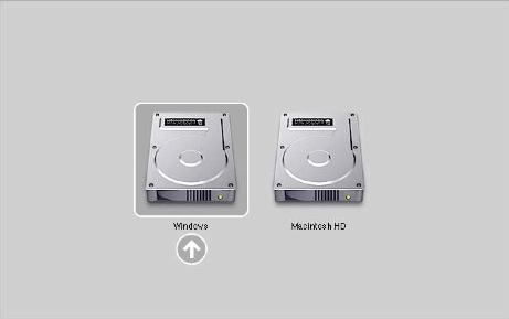

Have you tried holding down the OPTION/ALT key during startup and get to the boot selector screen and seen, if the CD/DVD shows up there? If it shows up, just select it and press ENTER and see if that works.
It should look like this, but only with one HDD icon and with one optical medium icon.
I've tried holding down the option key but only the Mac HD shows up.
