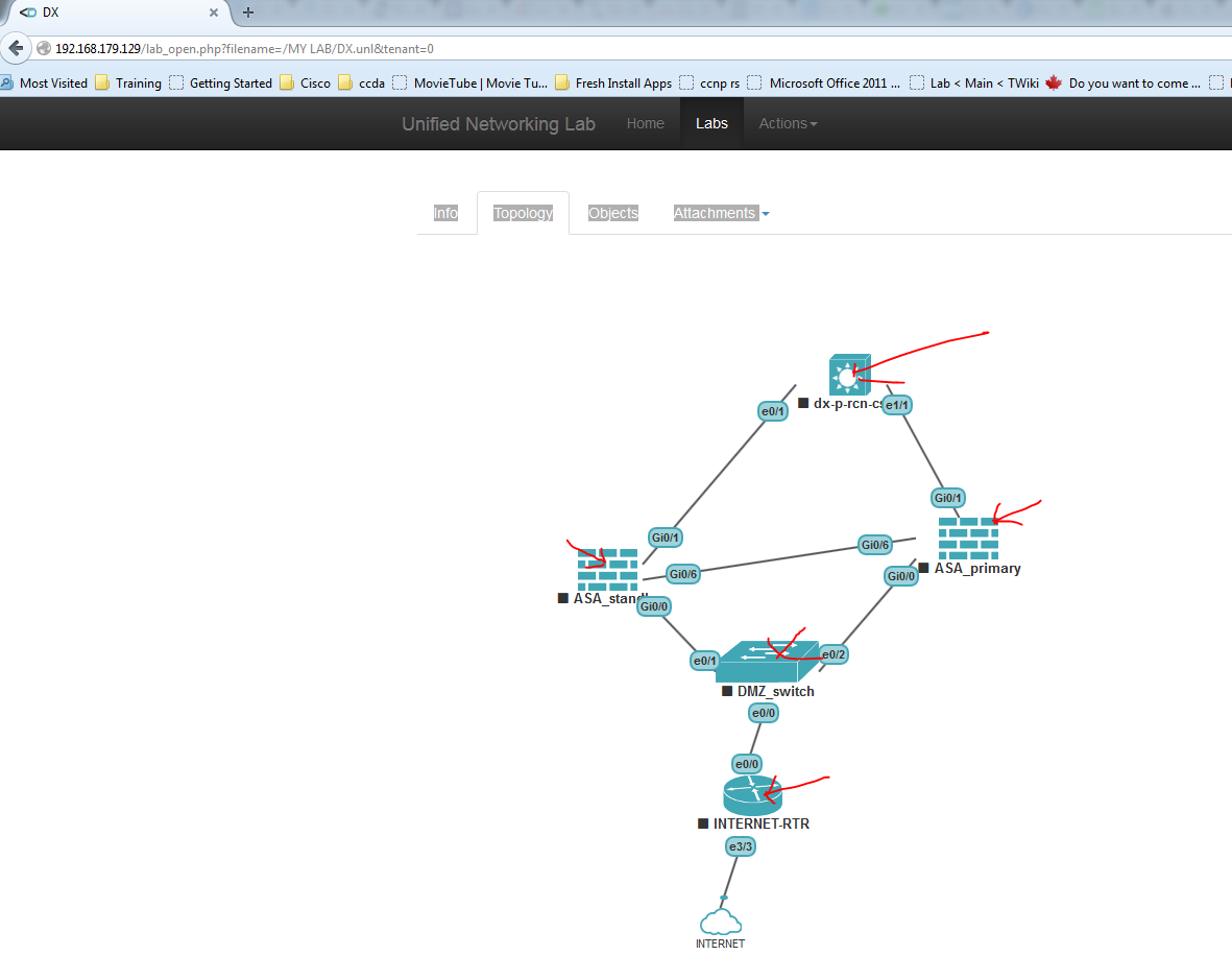

Hi,
I just want to find a way to click on a device in vm environment (example is a windows machine) and open it up via vnc. If you guys are familiar with GNS3/UNL/VIRL, you can click on a network, server topology and the device will open up in secureCRT, putty, terraterm using telnet or ssh.
I just wanted the same thing to happen in OSX.... my friend said that you can easily do it in windows and mocked my OSX as a typewriter that can't do anything (crying inside boohooo)

@Mikael H
In windows, you can use UNETLAB or GNS3 (it's a platform that integrates network platforms ie routers, switches, firewalls, windows OS, Linux, Load Balancers and others...
The VMware fusion acts like a router since it has all the subnets that will connect all of those instances, which means I can create a lab using private IP addresses and it will not go out of my network.
Now the UNL author was able to give registry editor scripts and batch files so that you can open those VM instances inside UNL.
The registry editor above is the one used for UNL. I asked the guy if he can replicate that script in OSX fashion but he doesn't use MAC

I am running vmware fusion in my mac and running a vm image of UNL (Linux based application)
http://www.unetlab.com/
This software is capable of running different network and server machines inside of it and connect them in a network lab scenario. Much like GNS3 if you are familiar with it... Once you have installed UNL and have the necessary images for your devices or servers or desktop, you can then http to UNL using the dhcp ip it acquires.

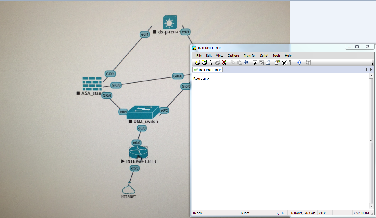

Now in windows, there is a batch file or script, and a registry editor that makes secureCRT, wireshark, and VNC connect and open a session inside the UNL application that is running in VMware fusion. I will attach again the file I have captured so you can understand a little bit more...
Now once you click those arrows, the devices will open a secureCRT or ssh tool (if you run the script and registry editor in windows)
Now if I connect a desktop machine (windows OS) once I click on it it will open a VNC session to that machine (If you run the script and the registry editor)
Could you help convert the scripts or we can skype so I can share my screen with you live? I just need this to run on OSX so I can continue with my work, you see I need to run different network scenarios for clients and test the configuration before deploying to their network...

What I am trying to achieve is that if anybody who is an expert in OS scripting (Windows and OSX) can interpret what the batch and registry editor files do for this program
* This program basically integrates all the VM instance or images of different network, security, server platforms and connects them together to form a lab environment where you can play around and experiment on different setups and designs.
Now when you click on the network icons on the program,
-if it's a network device and you configure it to be accessed via telnet or ssh, the batch files and registry editor will then automatically call either putty, securecrt or terminal if you can point to it.
-if it's a windows icon, the batch and registry file enables to open that server or desktop image/instance via vnc.

You are right UNETLAB is a virtual machine inside the VMware fusion Hypervisor. The UNETLAB can launch multiple operating systems (depends on RAM) for different platforms (Linux, Windows, Cisco, Alcatel, Veos etc..)
Is there a way for you to interpret the script and maybe create a step by step equivalent in OSX?
Thanks for your interest in my post!

On MacOSX with Safari, clicking on the icon will automatically bring up the right application, (with the exception of Wireshark).
Safari understands the telnet://address, ssh://address, and vnc://address URLs natively.
Safari does not understand the URL capture://host/interface
