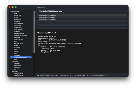

Can someone with a regular M4 Mac Mini, NOT the Pro model, confirm how many thunderbolt busses it has?
I believe it should have 3 (Bus 0, Bus 1, Bus 2) but I'd like to confirm before pulling the trigger on the regular NOT Pro model.
You can confirm the number of Thunderbolt buses in your Mac by viewing the System Report window

Is this what you need?
Reactions: joeriggs
Yeah I also see 0,1,3 (no 2).

@theluggage thoughts? It's so interesting that the Mac Mini skips Bus 2
but I would still think having a Bus 0, 1, 3 = 3 busses.
First off, the Mac Mini only has 3 TB ports so there are only going to be 3 active buses.
However, it has the same M4 system-on-a-chip as the 4-port iMac so the chip clearly has 4 controllers.
The mystery is what has happened TB Bus #2 on the M4 Mini... My only guess is that they're using it to drive the 10Gb Ethernet option
