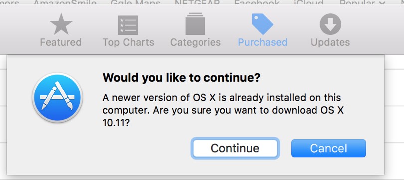

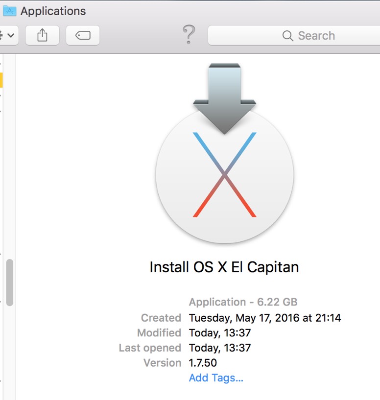

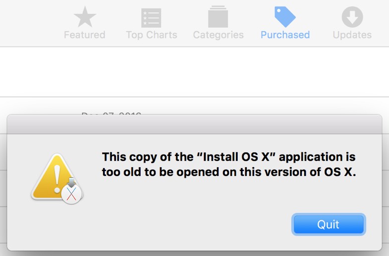

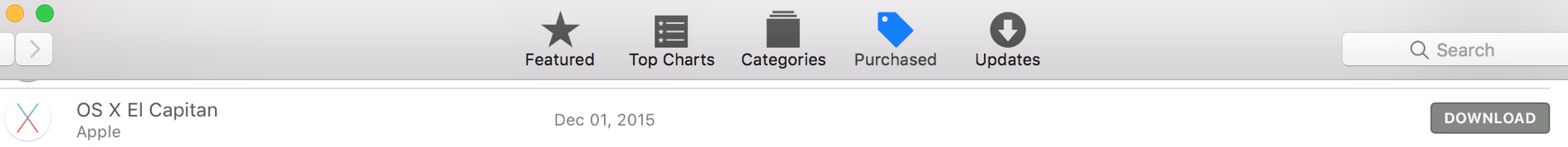

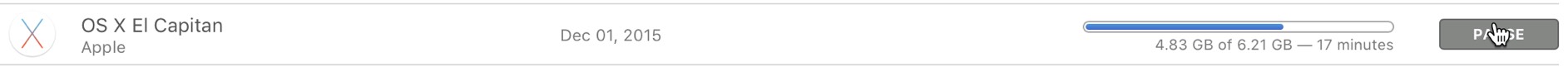

I was able to download El Capitan on my MBP running Sierra 10.12.2, I just could not install it.
Here is the sequence I saw:

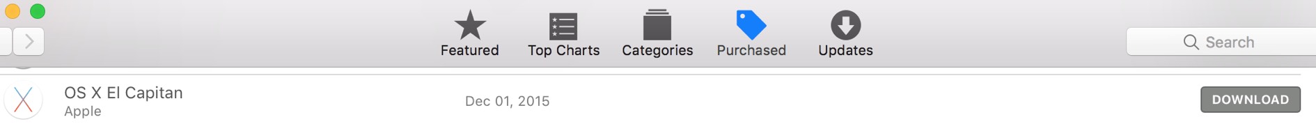

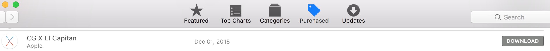

Shows as available to download from the App Store under the Purchased section;

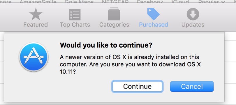

The App Store warned me, I pressed the "Continue" to start downloading El Capitan;

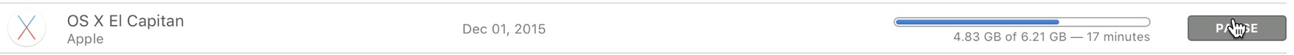

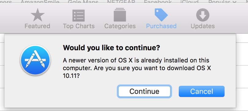

The El Capitan download in process;

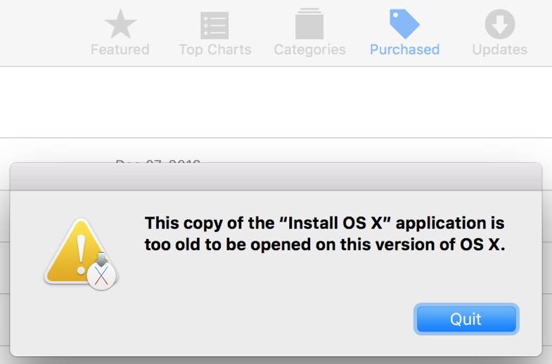

Warning that the El Capitan installer app can't automatically launch to install because I'm running Sierra. I clicked Quit. but;

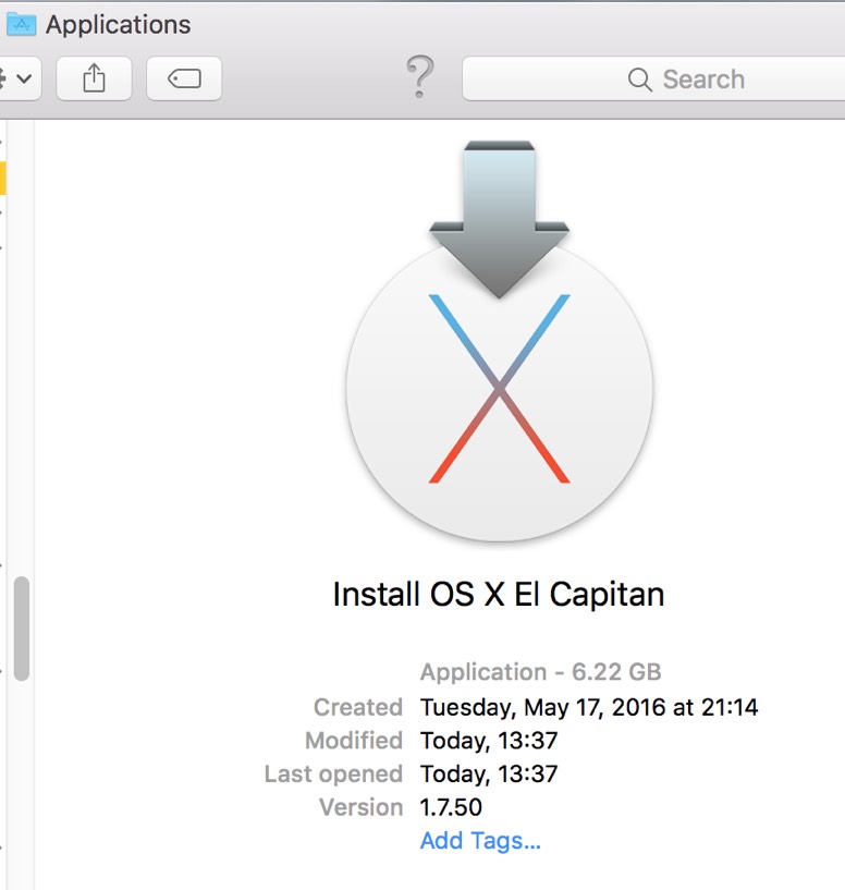

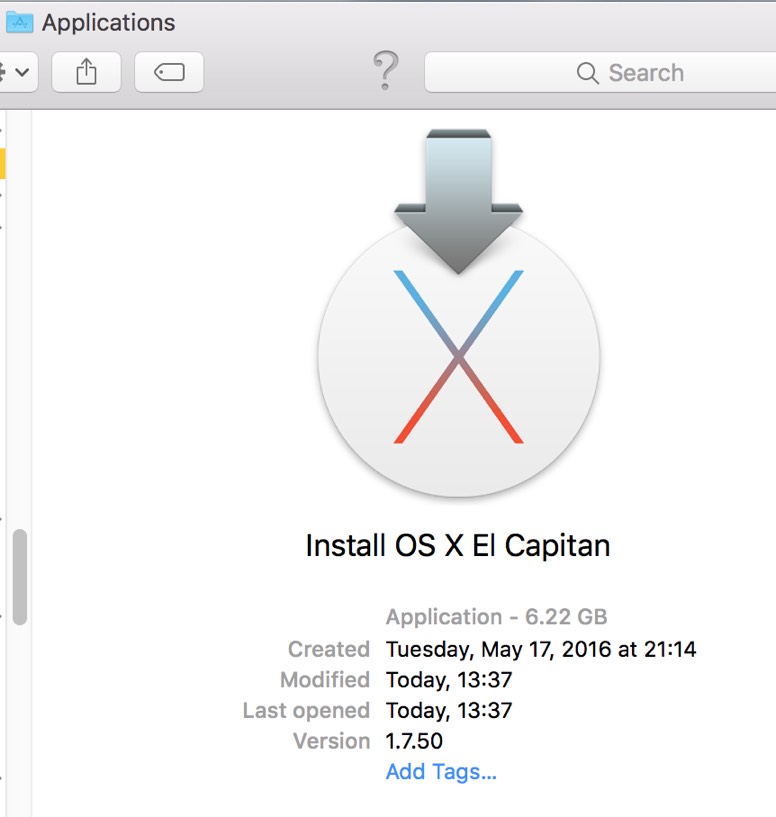

The El Capitan installer app is still available on the Mac. Check your Applications folder for the "Install OS X El Capitan" app;

So you got to exactly where I am now but I'm still not sure how to get past it. I get to the
I see the install El Capitan app in my applications folder but when I click on it I get that message so how do I get past that?
Any tips would be appreciated.
