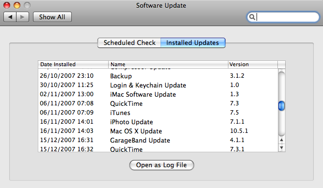

No I didn't clone the drive, I used the user Migration Assistant transfer option when you first boot up any mac, and then connected it to my imac this way. I thought it just transferred apps, settings, data that sort of stuff but i was surprised to see in installed updates quite a few references to imac updates?
I am weary now of doing a complete wipe and reinstall as when i use migration assistant again, it will surely copy across the imac updates?
I have quite a few Macs around my house that i can transfer my data too, but I also have quite a lot of storage space in the Pro to move things around onto and even have 2 external 1TB raid drives. Oh yes and I do backup using time machine so I can surely do a wipe/reinstall and the restore apps/data etc via time machine cant I?
I doubt the Migration Assistant has copied over any system files. I would say your machine is fine as it is. It may have copied across log files that show what has been installed, but I doubt that, too.
Are you saying that when you run Software Update, it lists NEW iMac updates?
Sorry, no it lists old imac updates that were installed.
I had grabbed a screen but forgot to attach to my last post, here you go...
Do you know what, I really am not sure what I did now in the excitment of getting my new Mac pro the other week!?
I am thinking that I may have even connected the Imac via firewire and then zapped the whole disk across using carboncloner.
Looking at these logs surely that's what i must have done as you say it would seem impossible that the imac installed updates should be on my pro any other way?
