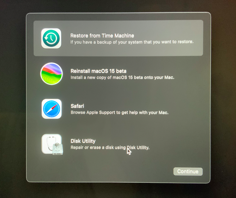

Furthermore if you already have sequoia it does also give you the option to reinstall sequoia:
In restore screen we see this:
So then select Reinstall macOS 15 beta and click Continue
This is likely going to look different but similar for future betas/release candidates/public releases
