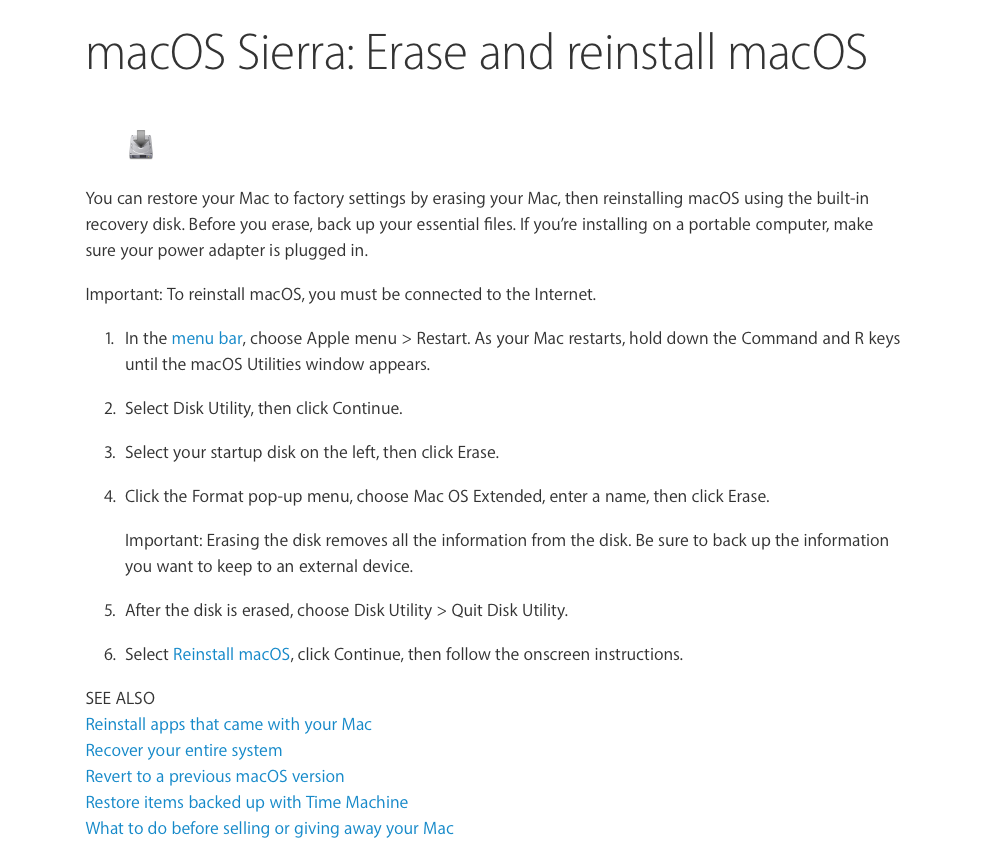

Would this work?
Yes it would. Only thing I would add is, do a secure erase instead of a normal one if you're concerned about the next owner being able to recover anything off the drive. This takes significantly longer as it has to write 0's to the entire drive.
Do I get that option in the same process?
