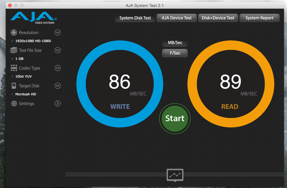

Download BlackMagic Speed Test (free from the Apple Store).
Then, run it on your iMac as it is now.
What kind of read/write speeds do you get?
With a USB3 SSD (like the one I linked to above), you should see reads of 420-420mbps and writes at 300mbps or better.
Will that be enough of a difference for you?
OP wrote:
"if I install the OS on an external SSD USB3 Drive won't that be slow as well being its using USB 3 to run the OS ?"
[doublepost=1515365983][/doublepost]
This is a Problem! LOL
