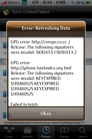

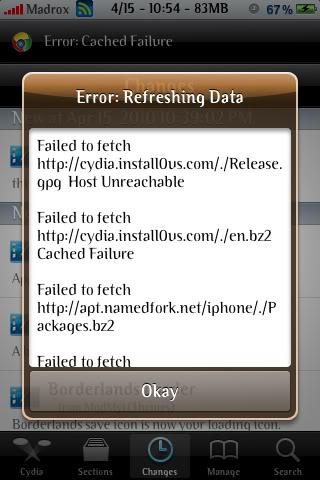

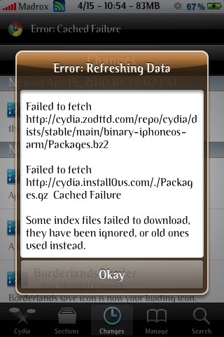

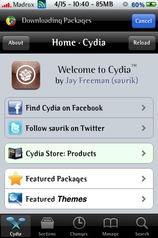

is there any way to reinstall cydia? mine is all messed up. i remember someone complaining about getting all these error messages from installing sources that are outdated and don't work anymore, so they where advised to SSH into the phone and delete some of them. i tried that and it just got worse and worse LoL right now it's to the point where it will sit at this screen forever and never finish loading unless i hit cancel:
then when i hit cancel i get this:
after i click ok, it refreshes and works, but i'm sick and tired of this, and i have a feeling it isn't updating and refreshing all the sources every time {i like to check for updates every few days}.
just now i tried adding a new source and it got stuck on that same step and i had to respring. it's really annoying.....is there any way i can just reinstall cydia without restoring my phone and re-jailbreaking it? i really don't want to go through all the hassle of that

Why dont you go into cydia and then manage sources and edit/remove the sources that keep popping up with errors.
You dont need to remove and reinstall cydia.
Yeah, I missed the big picture, since I was answering what he asked. If it's just bad repos (install0us is one of those...it doesn't exist or work), just manage them from Cydia (i.e., delete them).

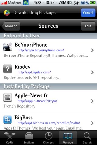

as you can see from the pic i just posted, they aren't listed in there.....that's why i thought starting fresh would be an easier idea.

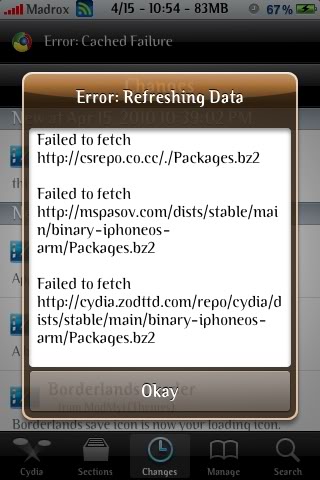

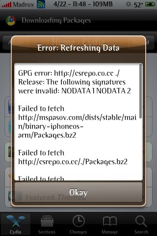

did that, now i'm getting this error {it never ends with my luck, i swear haha}:
and i didn't see them in the list i edited {only had 4, i deleted 2 of them}
Sometimes you're not going to be able to fetch a repo. It may be nothing. Do any of the messages mean anything to you?

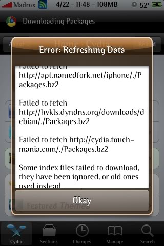

i have no idea what they mean, that's why i'm mentioning and posting them. it also "stalled" on me again {not finishing the "downloading packages", and having to cancel}
I found this link:
http://www.telesphoreo.org/pipermail/cydia-packagers/2009-April/000763.html
which was of many on searching for namedfork and cydia. Maybe if you look through the results of that search you can figure out what repo you need to delete.
Or maybe just post your repp list that you got from doing what Applejuiced told you to do.

right now, this is what that file consists of
deb http://repo.beyouriphone.com/ ./
deb http://apt.ripdev.com/ ./
that's it, i deleted the install0us one like you said before, and resprung. some of the ones i deleted a while ago, which caused this to mess up in the first place, where some that where in the "all sources" one, i remember that. that's where the ones from "installed from package" came from. but again, i'm just guessing here

Did you install anything from those repos that its still running on your iphone?
If a repo has been installed by a repo package, like from the repository section in Cydia, it can only be uninstalled by uninstalling the package.
Also look into this section of your iphone thru SSH and see if you locate anything with the name of the faulty repos that keep popping up.
private/var/lib/dpkg/info
If you do remove them.
Sometimes repos are really packages, in the sense that they are installed as packages. You delete them by uninstalling the package, in Manage... Packages.

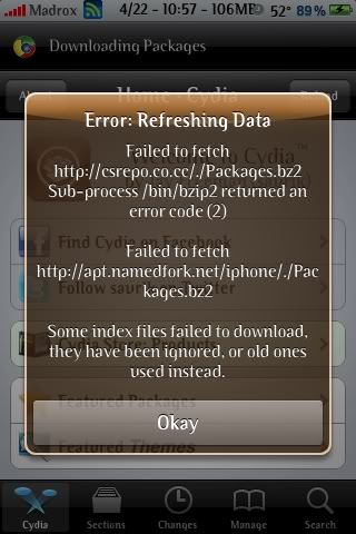

ok, the only one left in the lest is beyouriphone. now i'm getting this error:
i'm guessing they came from the package "all sources" that i installed a while back....but i don't remember what apps i have from after installing that package. if i get rid of the whole package of sources, will i loose the apps i downloaded off of them?
