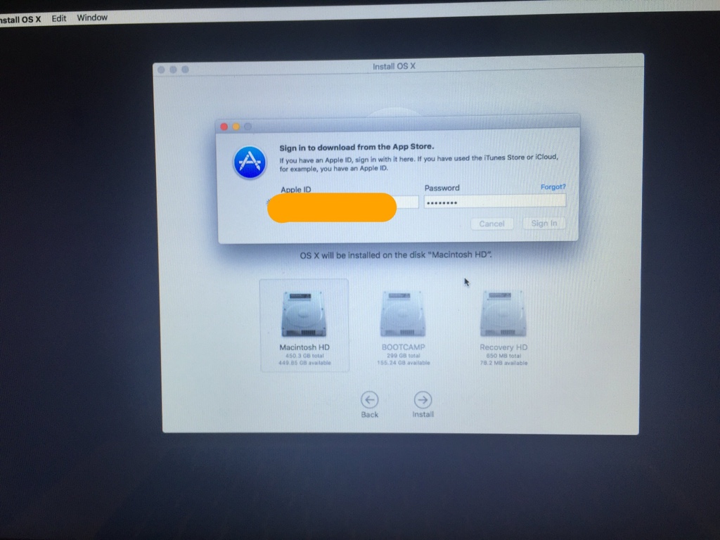

I'm trying to reinstall a fresh copy of OSX EL CAPITAN and I got stuck here for hours
1- The same OSX was already installed on this MacBook pro
2- it is early 2011
3- I had made the most secure erase of the disk before attempting to reinstall (7passes)
4- it does not give me any other option to download any other version of OSX

Lol , yeah except I can't login to go to the App Store, as it's fully erased
My bad. lol I can't tell from your picture but, did El Capitan create a recovery drive? Did you try booting into Command +R, and installing via that option? It should tell you if you will be installing El Capitan or Yosemite with that option.

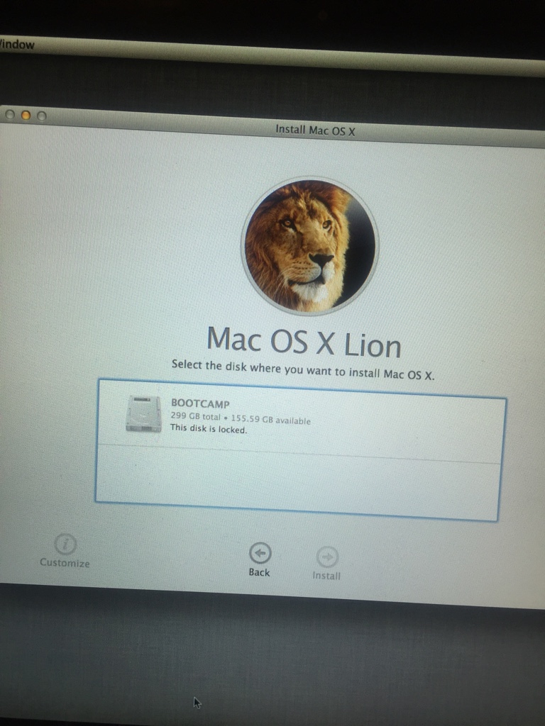

Ok here pops up another issue , ok it shows that I can reinstall OS X LION, which is fine for me I can upgrade later! Except I can't see the disk where I want to install, the only partition I see is my boot camp drive!!
OK, quit the OS X install, which will take you back to the Internet Recovery screen. Choose Disk Utility, either from the window there, or from the menu. If Disk Utility shows your hard drive, select it, then click on Repair Disk.
Keep in mind that the 7-pass erase that you did, can be a poor way to treat an older hard drive, and you can hasten an early death of the hard drive,
Hopefully, you will be able to sort out the hard drive in Disk Utility when you try the Repair Disk.

Well, problem solved!
I went to the disk utility finding Macintosh HD was in grey like unmounted, tried to mount it nth happened, so tried to repair message said it is all right.
So, I tried erasing it one more time the fastest way, and it came back to business!
Now I'm installing OS X Lion and I will be upgrading later!
