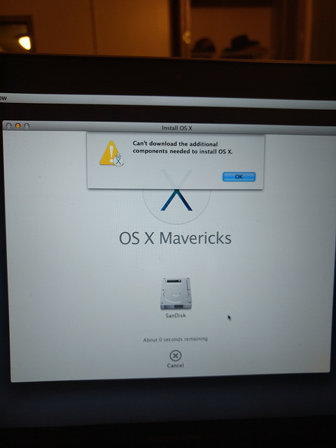

-Internet Recovery: I have tried over both WiFi and Ethernet. Both result in a message saying "about 5 minutes remaining", it gets to 1 second, goes back to 5 minutes. This cycle repeats for 15-30 minutes, at which point I get the following message.

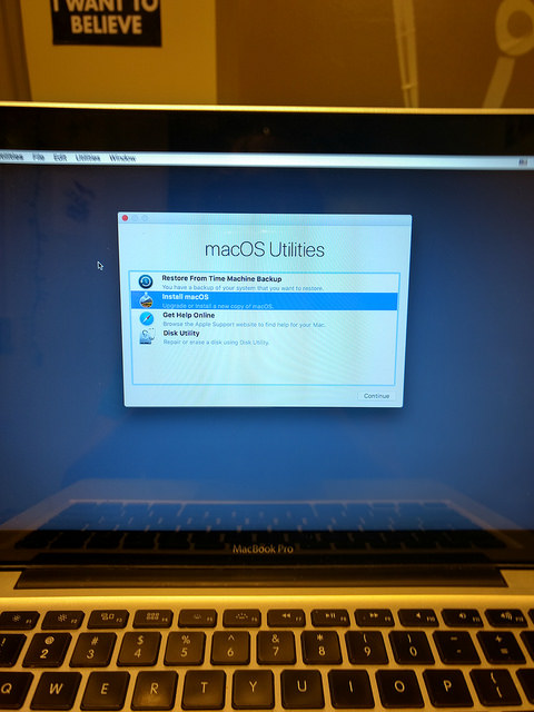

-Bootable USB Drive. I made a High Sierra USB drive using Install Disk Creator. Booting to this led to this screen:

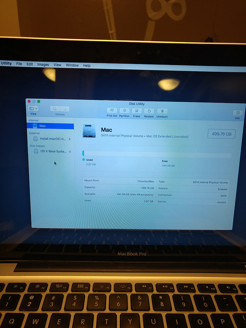

It went to an install screen and progress bar, took about 3 minutes, and rebooted to the prohibited symbol. After 10/15 seconds, it changed to the apple logo and and a loading bar. It slowly moved to 25% loaded, and then jumped to the MacOS utilities screen shown above, without any signs of having actually installed anything. This is what disk utility shows.
The SSD is formatted as HFS+/MacOS Extended, and I tried the High Sierra install with it formatted as APFS - made no difference. I've erased and reformatted multiple times, it's set to GUID partition table. I've tried Internet Recovery and the USB drive multiple times and get the same results. Any ideas? (It boots and runs fine with Linux Mint off a USB, that's what I'm using currently)
