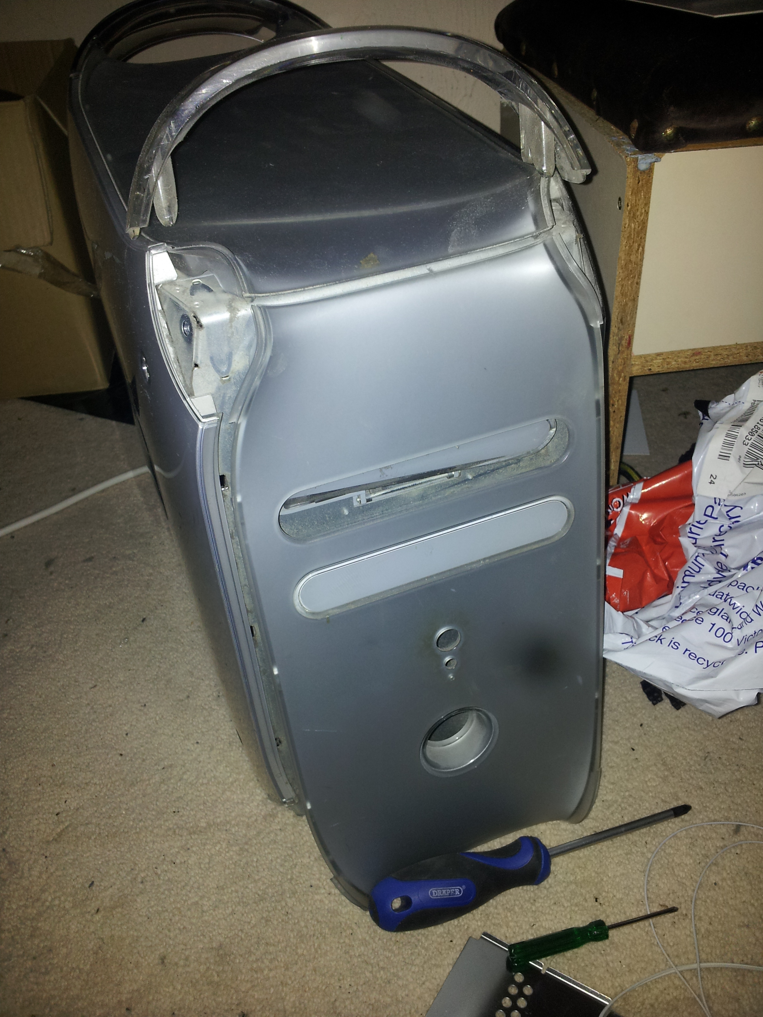

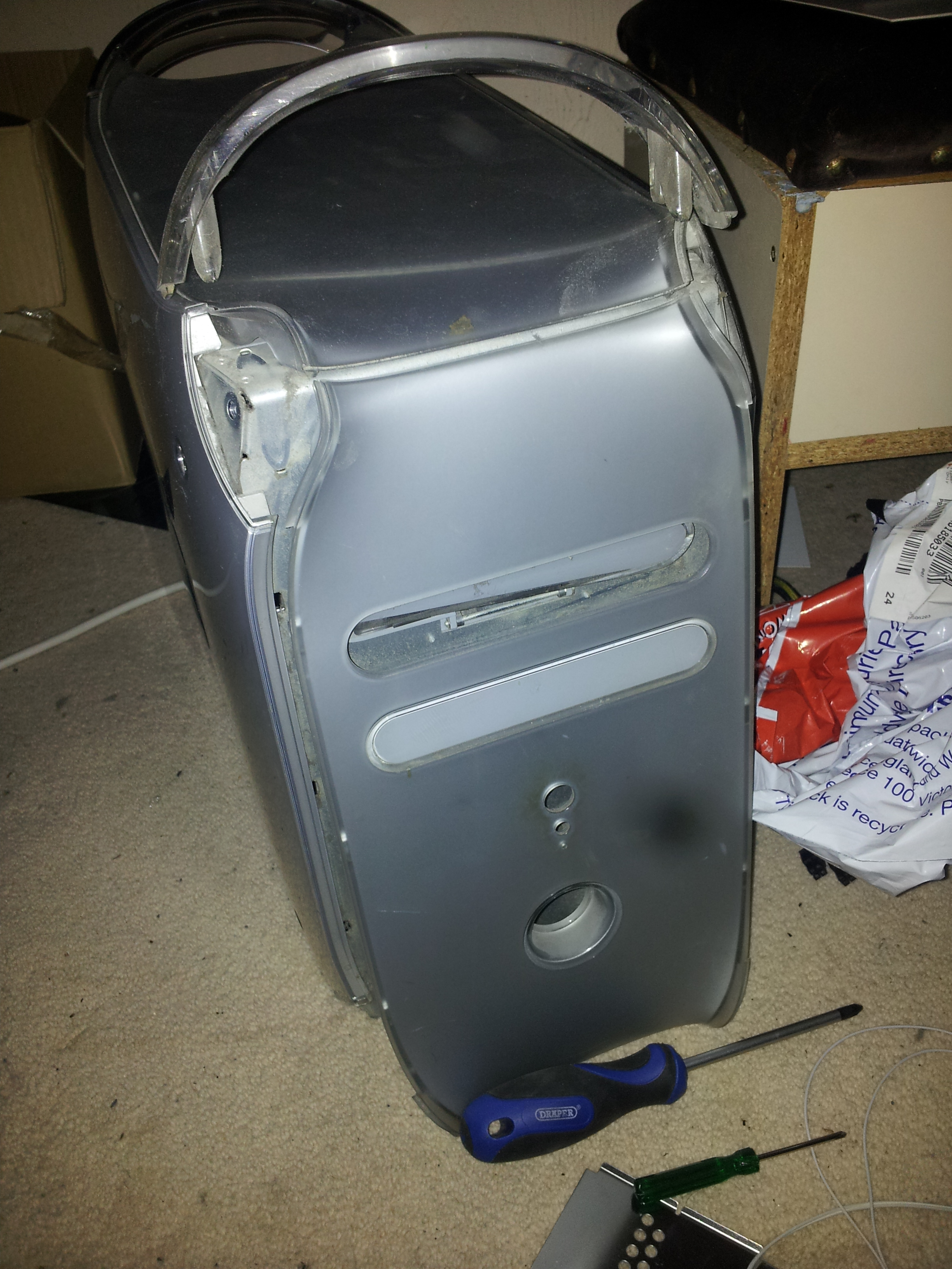

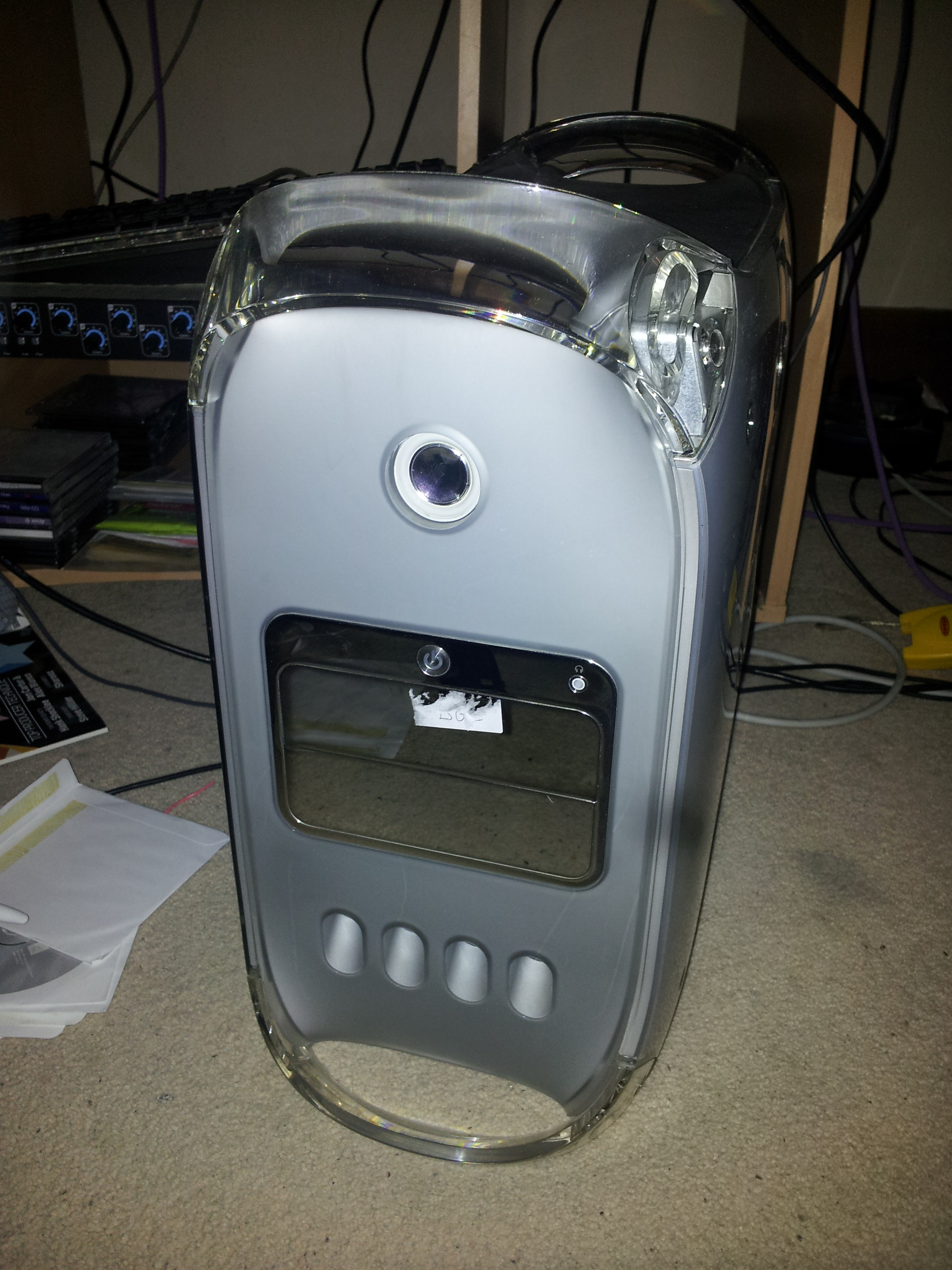

I've attached a couple of snaps. The partially disassembled one in the photo is the old G4, and the shiny-looking one - well, I'm sure you can guess!

The Mac on the left, the partially disassembled one, is a Quicksilver. The one on the right, and the one you are having the issue with, is an MDD (Mirrored Drive Door). Otherwise known as the Wind Tunnel.
As Hrududu states, if you have a FW800 port on the back, well – you're done. The MDDs of that model and later do not boot in to OS9. You can keep trying until eternity ends, but it won't happen.
