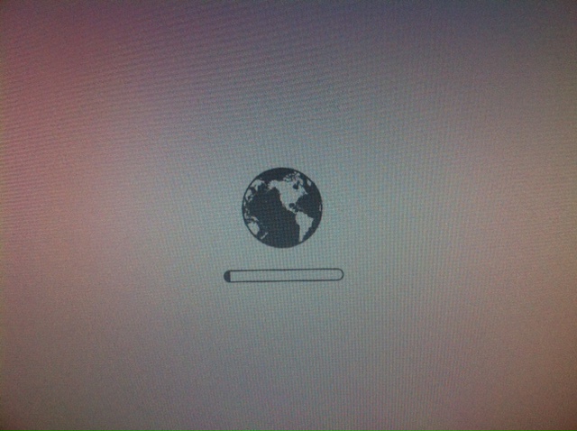

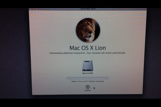

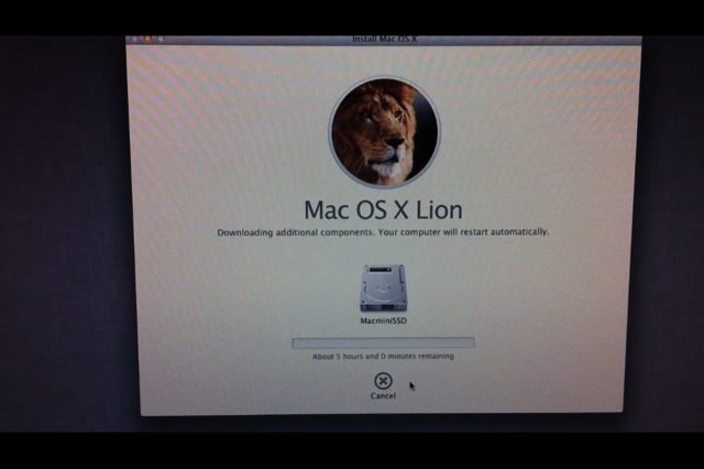

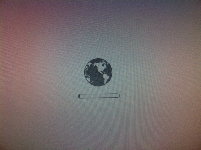

I have just taken apart a 2.5 i5 Mac mini, removed the 500GB drive and replaced it with an SSD (OCZ Vertex 2.)
I created a bootable OS X Lion USB stick from my Macbook Air, and tried to boot the mini from the USB. It failed, so I am currently using the reinstall via the internet method.
Still almost an hour to go...
