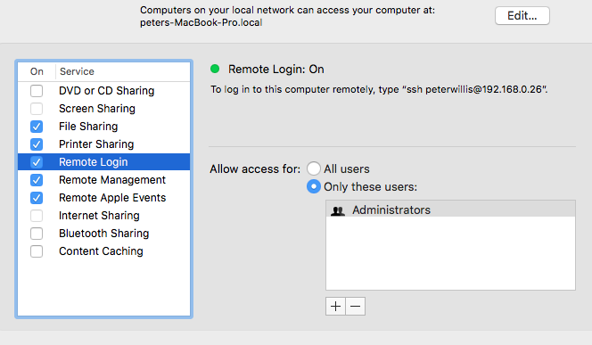

This is what I have enabled on my MBP in Canada. What settings do you recommend for my MP 5,1 in France? I have someone there that can adjust if needed).
Many thanks!

Note that the Remote Login setting in your post only applies to logins via 'ssh' on the local network -- by itself it won't work for login from any other network (like over the internet). Theoretically one could use port forwarding on the router, then (somehow) discover the remote network's IP address and then connect with ssh, but IMHO it's far too risky. (Any internet hacker could connect and try to guess or bruteforce your probably simple login password.)

You don't need the ARD app to remotely control a Mac over SSH; this can be done with the built in screen sharing app. Again, something like Jump Desktop or Screens is far more flexible and better suited for this rather than leaving vulnerable ports open on the remote internet connection all the time.
But did they just turn on those settings in System Preferences, or did they configure those settings and configure the network properly? We don't have that information.
