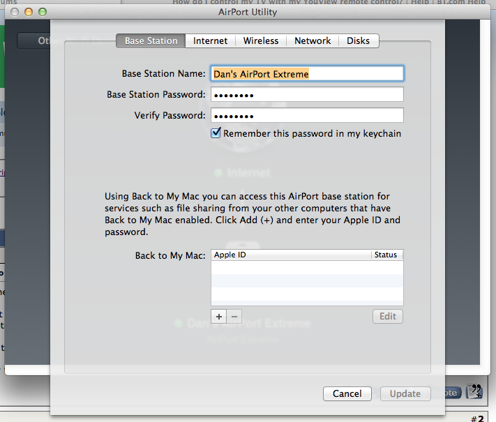

In AirPort Utility, set it to "Allow Setup over WAN". You are going to need to ensure your AirPort is the only router on the network, and the modem in front of it is a simple modem and not a router! If it is, you must set it to bridge mode.
You also must know your public IP address and the log on for the AirPort!
I can't find an option to allow setup over WAN?
I am using Airport Utility 6.3.2 on Mavericks.
You can see it here in the Base Station tab.
I don't have that option in my AirPort Utility!

Your airport is in bridge mode isn't it?
And/or it is used as a wifi only access point...
Either way it isn't your main router right?.
I have fibre broadband modem which feeds into a BT HomeHub and then into the AE which provides the WiFi.
Will it not work in this configuration?
Nope. AE wold need to be the first device after the Broadband Modem. Your BT Homehub probably has its own firewall and what not. How would your AE communicate with the outside world if the BT Homehub would block it? I have several AE's at my house. The ONLY one that I can reach from the outside (if I turned on WAN access) is my main one that does all my DHCP and is directly connected to the Cable Modem. All others do not have this option because they are "inside" the network.

You use Airport Utility. Start Airport Utility then go to File menu then Configure Other and you will get this window.
Never used this myself, so let us know how it goes.
You can DL Airport Util for Windows from Apple and try that. I just looked in the iOS version of Airport Util and I don't see that option.
You are right. AirPort Utility for iOS cannot remotely connect to an AirPort Base Station! The final version for Windows can however!
