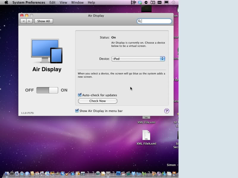

Thanks, I decided on your option 1 and downloaded airdisplay, and everything seems fine using the mirror mode, except I get a grey slab down the right hand side which I can't shift no matter what settings I try.
Its even there on the normal non-mirrored setting....I wondered if you knew what was causing it. 😱
Check for updates for the server. I got an update this morning when I was testing this, and it eliminated this problem. Current server version is 1.1.0 (7175).
Oh, and if you haven't noticed this yet, you really need to lock the orientation of the iPad when using AirDisplay. Otherwise, it will disconnect every time you flip the display.
