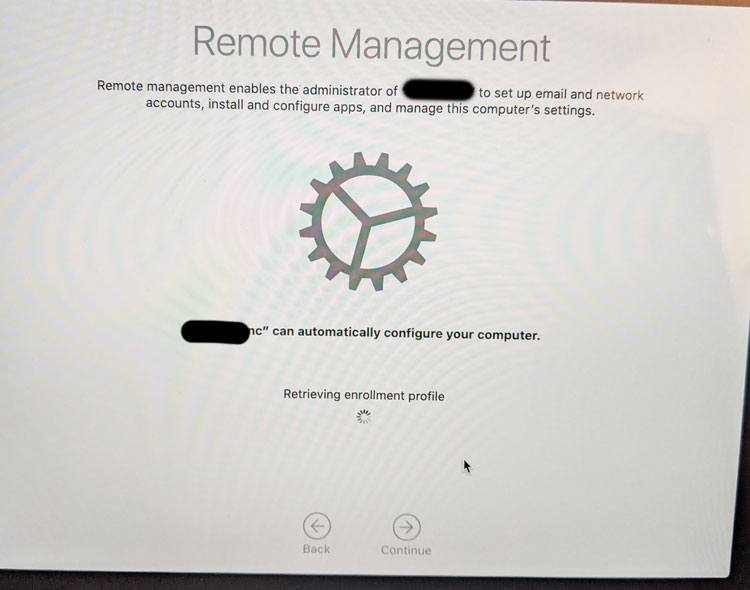

My post from earlier today is the last one in the discussion as of now. I bought a used 2014 MacBook Pro Retina from a local Mac repair/resale shop, more than 2 years ago. I used it without issues, including upgrading the OS which is now at Catalina. Then this week I got a new M1 Mini, and a good quote for the rMBP from an online Mac buyer/reseller. Today I erased the HD, and then in recovery mode attempted to re install the OS. I got hung up at this screen about two clicks in:

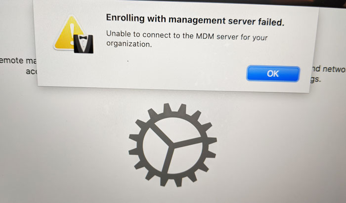

Followed by:
I found the named company online and contacted them through a generic support email. They replied and asked for more information and now they are "working on it." It's possible that I bought a stolen computer although as I said I bought it from an established retail and service shop that's been around for a long time.

Quick update: I have now heard from that company, that they had sold the MBP but it was accidentally not removed from their MDM program. They say they have now removed it, and I should be able to erase the hard drive and reinstall the OS without any problem. It's a relief to know I wasn't using a stolen MBP, but I'm disappointed in the shop where I bought it used. If they had done an erase and clean OS install they would have encountered that remote management lock screen, and had to resolve it. Instead they somehow cleaned up the machine and sold it (to me) without doing that. It's a reputable shop that I've done business with in the past, so the disappointment is real.
