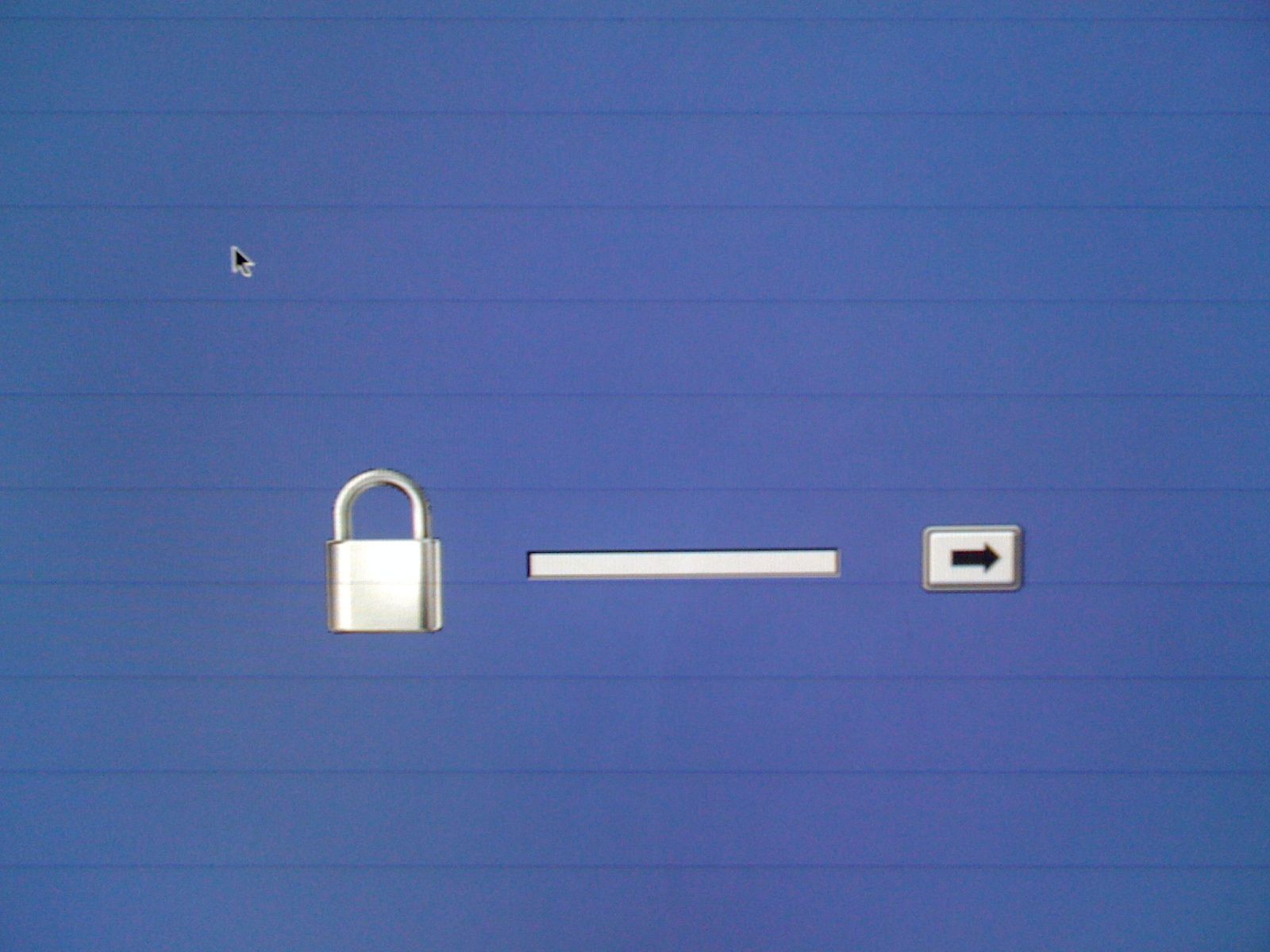

So one of my MacBook Pros were connected to an eMac. I saw the option "Erase" and I went for it. I know that I am a massive idiot, but it just felt good. As soon as I realised that I made a big mistake, I started playing with the other eMac. I went through some options and I don't know how, but now I have two unresponsive eMacs. The second one actually had a working optical drive but at one point, it started showing the padlock. Well, I'm sorry but I don't remember my girlfriend's birthday. How should I remember the master password on a computer that I haven't used for several years?
So my question is: how do I recover two half-dead eMacs with an Intel MacBook Pro?

Reset firmware password:
Hold ⌘+⌥+P+R on the keyboard and power on the eMac. Keep holding until you hear the third chime.

Change amount of RAM first (add or remove one stick). Without it, you won't be able to do PRAM reset even once. Next do what Giuly said.
