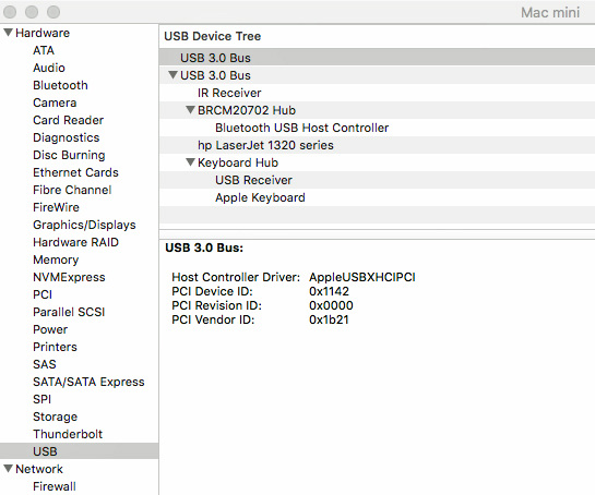

If you go to the "System information" app, and click on "USB" (on the left), does the drive "show up" in the list you see on the right?
The SATA/IDE to USB adapter doesn't seem to be listed in USB System Information, nor does the removable drive (see the screenshot with this posting).
The USB cable is 2.0 as opposed to 3.0, if that makes any difference.
The USB System Information does say: "USB 3.0 Bus" but I would guess it's backwards compatible to accommodate a USB 2.0 cable. Still, I could try using an adapter the comes with a 3.0 USB cable.

I'm going to -guess- (and it's only "a guess") that something in the adapter -- or perhaps something in the adapter+drive combination -- isn't quite compatible with the Mini's USB.
Might be the controller chip, might be something else.
Sometimes, try as you might, it's just darn near impossible to get a particular piece of hardware to work with another piece of hardware.
