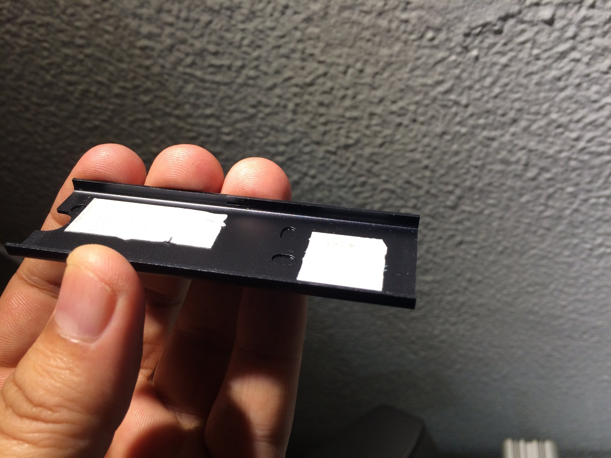

flyinmac, thank you for this response. Sad to say I am indeed talking about heatsink not about adapter. [I've not ever uploaded files to this forum and so let's hope the following images are visible!]
Beetstech 'ultimate guide' page talks about 'extremely strong thermally conductive adhesive' and so I worry there might not be an easy way to remove heatsink from SSUBX?
> The Mac Pro supports all capacities (128GB – 1TB) of Gen. 3 SSDs, but originally included drives with heatsinks that are attached with an extremely strong thermally conductive adhesive. It’s generally a safe bet that if Apple’s engineers decided it was necessary, it’s probably necessary, but it’s worth mentioning that the Mac Pros can use SSDs without heatsinks found in the other devices, and our internal testing showed absolutely no difference in SSD temperature when using drives with and without heatsinks, even under stress test conditions.
So..yes..because heatsink increases the footprint of SSD-in-laptop, the SSD becomes too big for my 11-inch MacBook Air. eBay seller's page listed my computer as one that's compatible with the product and so I'm bummed!
Anybody knows how I can remove the heatsink without damaging the drive?

I think Apple used the adhesive on this drive, so in my opinion I would avoid an attempt to remove it. You most likely will damage the
chip, because the solder points might be weaker then the adhesive glue. What I would probably consider is to use a dremel grinding wheel and cut off the extended size, so it can fit the laptop.
The question is however, do you have a dremel tool and will it be flat enough for the laptop. The additional thickness might be a problem.
So you might as well consider to put it on eBay and buy an OWC version flash drive that is designed for the Macbook Air as an upgrade.

You can remove the heatsink with sharp snapp-off utility knife. Start cutting gently from rear of the drive and work your way towards the front. Avoid twisting or bending so you won't damage the drive and/or snap the blade.
Update; I recently removed the heatsink from a SSD in order to fit the SSD in a MacBook Air. Using a long bladed utility knife, the process was pretty easy, done in about two minutes, and left no residue on the SSD and no damage to either the SSD or the heat shield.
