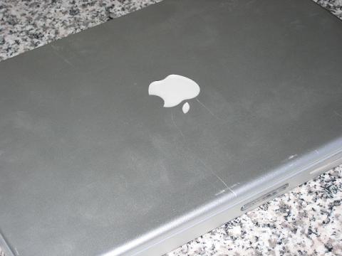

I'm wondering if there is a product that anyone knows of that would remove/minimize the appearance of scuffs/light scratches on the Aluminum PowerBooks? I'm not looking for a paint product, but if you've used one with good results, I'd love to know about it.
Thank you all very much in advance!
(Below is a sample of the scuffing. I'm not looking to remove the deep scratches, unless you know how! 😉 )

At this point, I'm thinking my best options would be iCleaner polish and/or iKlear cleaner. Can anyone else vouch for either of these products?
This is an area where I have some knowledge, and it's mostly the what not to do knowledge.
Basically, unless you plan on removing the lid and having someone sandblast it and re-annodize it, just leave it alone.
If you polish to hard, you can break through the clear annodizing and it'll look like crap. The scratches in all likelyhood have gone through the annodizing so in order to polish them out, you 'd ruin the finish and it would look worse.
It's possible there is something that could fill in the scratch, but I think that is largely dreaming.
You can go and get a new lid for $100 and it's pretty easy to install (sometimes they show up on eBay as well but most of the time they have the LCD attached). Aside from that, my suggestion is pony up the $100 or leave it alone. I can show you some pics of what it looks like when you rub through the finish.
I'm going to echo all this. And add one thing: NO BRASSO OR ABRASIVES OF ANY KIND! Abrasion removes the thicker than normal layer of aluminum oxide which is what makes anodized aluminum so special. That's a bad thing, mmmkay?
