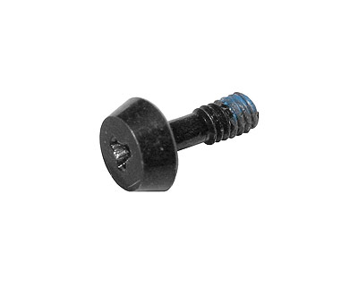

The screws that hold the battery in place (Triwing Ones) One of them is stripped on my MBP.
I ordered some new ones and they should be arriving next week.
Does anyone have an idea how to get the stripped one out? I have tried pliers but they don't seem to grip the screw to be able to turn it.
This is the screw I mean.
try using a flatblade screw driver in two of the "wings", they also make special drivers made for removing stripped screws but they usually are not for screws as small as those triwings.
You can also try looking for a little bit bigger than the correct size triwing driver, those are going to be hard to find though.

Xcelite 175M will remove any stripped screw in the right hands, by grabbing it from its sides tightly. It won't ruin the screw, and it always works.
I might try those Xcelite 175M but I don't know if the gap is big enough to be able to use them. I tried with some pliers but couldn't get it to work as there was not enough room to turn them properly and get a good grip.

I don't know what access you have to small electronics tools, but there is a tiny little wire cutter you can get. It may be small enough to fit in where the screwdriver goes and on the side of the screw. I have done this a couple of times with larger screws and ones where I didn't have the proper head.
I usually just use pliers and squeeze as hard as I can (around 40lbs, tested it in class once 😛 )
you could also try to solder a pice of metal onto there.

My neighbour managed to get the screw out for me today and I replaced it with one of the ones I ordered from BookYard 🙂
Last time I stripped a screw was on a desktop and I drilled it out. How did your neighbor get it out so future strippers may know?
He hit the sides of the screw with a screwdriver I think to loosen it up and then he managed to get it with the pliers it took about 10 minutes going at it with the pliers but it finally loosened.
