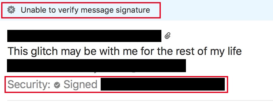

Whatever he did (he cannot explain nor reproduce what he did to create this result), now all his emails come through with headers that look like this:
(note areas outlined in red).
On a visit, we checked and verified that all "signatures" are now removed from Mail.app's settings. But still, sent emails (from him) display the "unable to verify message signature".
I checked his keychain, and removed what looked like a signature certificate from him that looked like the culprit. But... no change.
Where else can we look where to remove "the cruft" left over from his failed signature adventure?
How can we make Mail.app "forget" that it ever HAD any "signatures"?

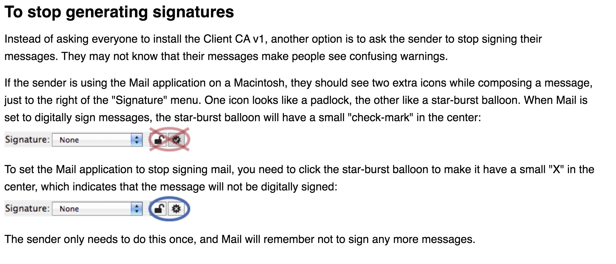

Apples own support forums reference this issue and says the only solution is following what is on an MIT Knowledge Base entry. However, many other posters then chime in thinking this is a bug "somewhere else" manifesting as this message.

Here's the pertinent info (screenshot) from the MIT page linked to above:
I won't know if this works or not until the next visit to the friend's.
Will try to follow up later.
A followup:
My friend tried the "MIT solution" referenced above, and that seems to have solved the unwanted signature problem. He sent me a test msg and it no longer has the "unable to verify" notice as illustrated above.
