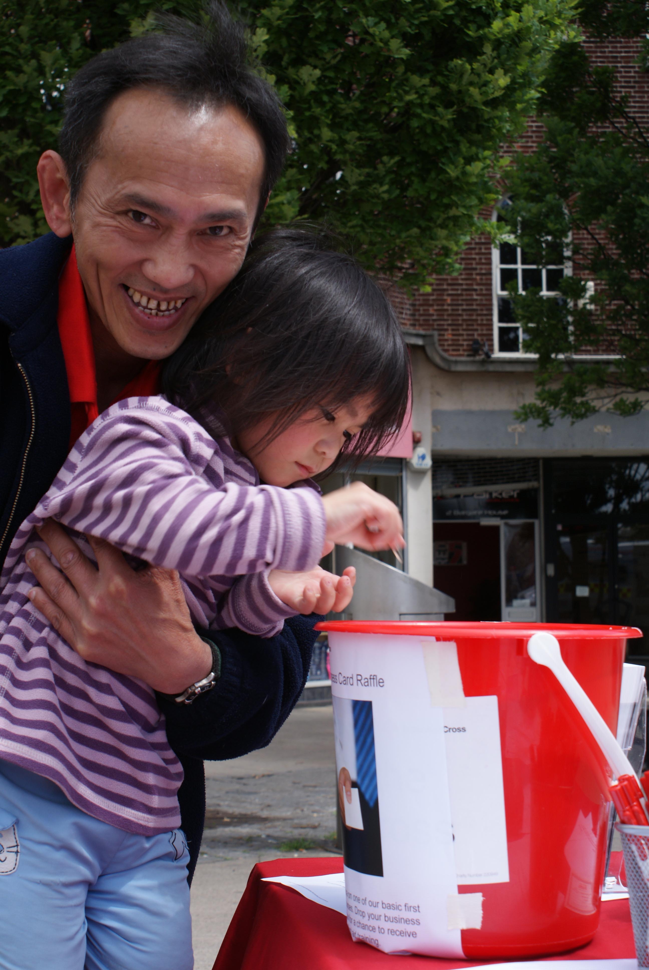

I have been alot of photos recently where the background has been removed, so that you can only see the subject....
But i can't seem to master it? I have read tutorials but i seem to allways get a crap results.....

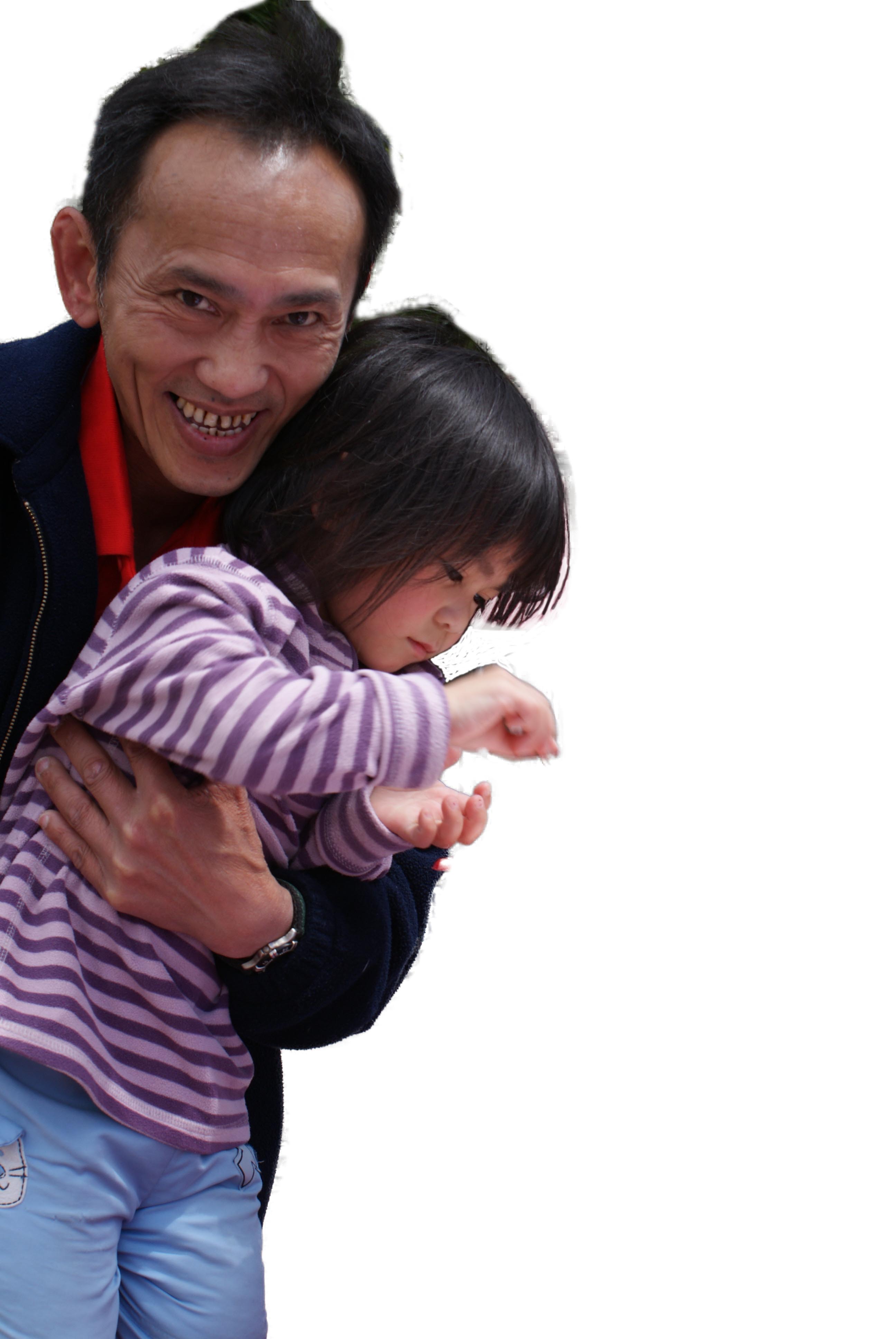

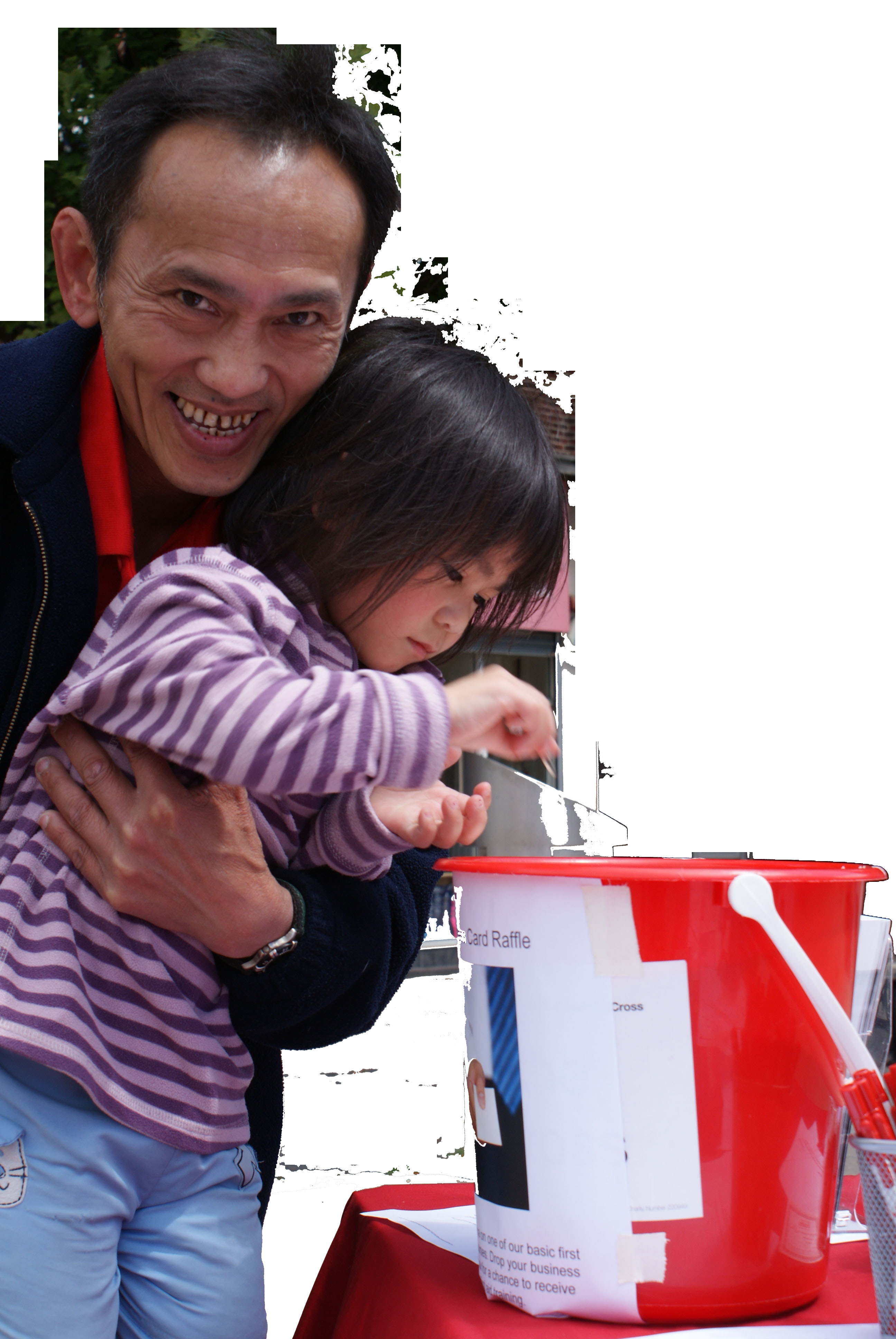

I'm using Photoshop CS5.5 but, i don't know it that well... I have attached the photo that i'm trying to do and also my result so far....

This type of work is best done on photos that have a good deal of difference between the foreground and background. I would do this with the same tools mentioned by Matt. It would take ages and I wouldn't be satisfied with the results.

Yep. Even the most skilled Photoshop user would not be able to knock the background out of your example photo.

even going pixel by pixel, hair seems to be the biggest pain in the arse in these situations. Commendable job, dslade90😀

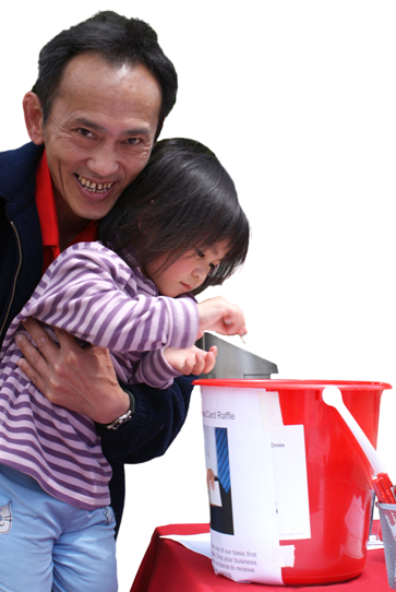

Thank you Ravaroo I appreciate it. Here is the other one with the bucket. Yes the hair was a killlerrr!

cheers for tips guys. Yeah, my main problem was the hair too because it blends in so well. thanks anyways!🙂

With CS5, there are some enhanced options to improve masking. You might want to practice by shooting an image with a simpler background in order to improve your technique without getting too frustrated. The image you posted is very difficult to separate.
I have had good success with using the quick selection tool to get an approximate selection of the foreground you want to separate from the background. You can “push” and “pull” the selection closer to the edges by holding down the shift key to add to the selection, or hold down the option key to subtract from the selection. Then I use the Refine Edge button in the tool option bar. This will bring up a small window with a lot of options to refine the edge of you selection: Edge detection, which helps refine the edges in complicated areas such as hair; Adjust edge, which allows you to adjust the selection by smoothing, feathering, contrasting, or shifting the selection in or out. You would probably want to be conservative with the strength of these sliders. Finally, there is Output. I would select decontaminate color, which is a great way to “color” in areas that are difficult to separate, like in hair. Then I like to select the output choice of new layer with mask which is nice because with the mask, you can refine your selection even more by brushing in white to reveal or black to hide.

Some good attempts at this so far...here's mine
