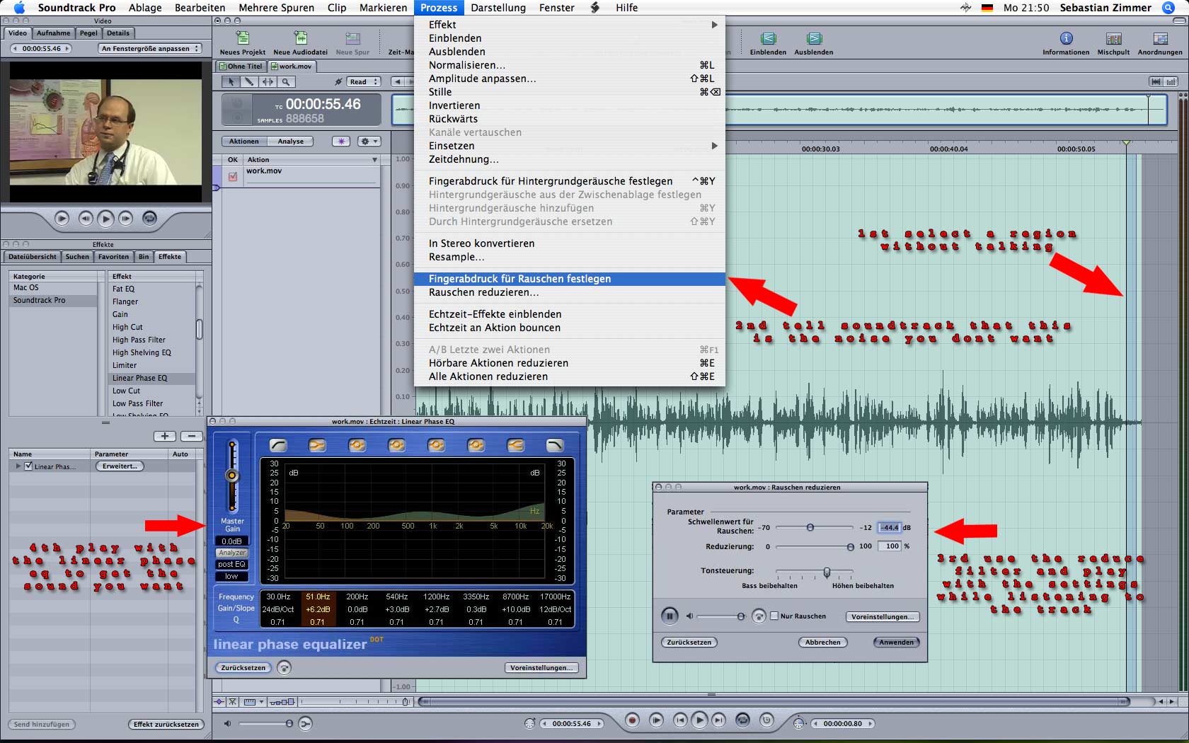

How is this... I did a really quick job in Soundtrack with a noise reduction filter and a linear phase eq. If you want detail let me know.
that is soo much better
can u please let me know what you did
all the clips were filmed in that docotrs office so i could use very simlar attributes on all of them
wow u really cant hear the hum at all in that one and the voice isnt too distorted.
I am pretty new with soundtrack pro, i got it a while ago and never had any use for it until now.
here you go, these are close to the settings i used. I must have erased the original, sorry.
