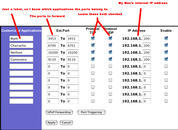

Poke around in your Router via the web interface and look for something called Port Forwarding.
It should be a bunch of blank fields, labeled something like "Port" "Computer IP" and maybe checkboxes "UDP" and "TCP".
Anyway..when you DO find this, and its got to be there..every router has port forwarding. Enter the port numbers you got from Apple, and also whatever ones you games/Gameranger need open. In the field that asks for your machine IP, type the INTERNAL address of your Mac(you can get your IP in the Network pref pane). Also, if there are UDP and TCP boxes, check em both.
See, a router works like this-
Info comes into your ISP, then is routed to the IP your ISP gave you. If you are connected to a router, then the IP your ISP gave you is entered into the router.
So when somebody types your IP in to connect, they just hit your router and the data does not come through. To fix this, you tell your Router "When data comes in on these ports, send it to this machine". That is what port forwarding does.
It is easier to just DMZ, but not nearly as secure, and it is good to learn about port forwarding so that if you ever have more than one computer and cant/dont want to open them all up to net traffic.
I have included a picture from my Linksys router as an example.
