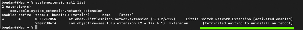

That is not true. Install and uninstall LuLu to see how a proper system extension should behave https://objective-see.com/products/lulu.html

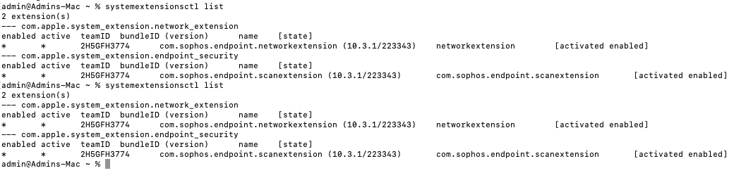

The “Remove Sophos Endpoint” app does not stop the extensions and does not trigger the rebuild of the AuxKC (Auxiliary Kernel Collection). That's the problem.
Here is before and after running the “Remove Sophos Endpoint” app
