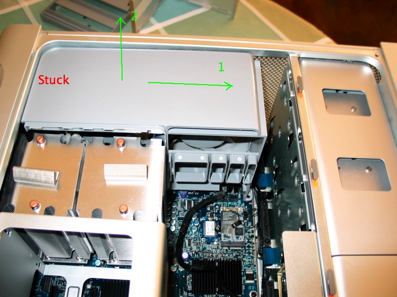

I'm trying to remove the front fan assembly on the 2006 Mac Pro and it's giving me a hard time. The top part near the screw popped out easy but the bottom is stuck. I'm not sure how much force to use or in which direction to pull, straight out of the case (2) or upwards toward the hard drive bays (1)? I tried easing it in both directions but it won't budge. Thanks.

You need something like a PCI slot-cover to use as a puller. Tuck the short bit under the plastic at the top-right of your photo and give it a good (but not excessive) tug in direction (2). As long as you've removed the screw, it should pop out OK.
Reactions: Arom Shelby
Thanks. I already did that. The top right (near the screw) is completely lose already. Something is holding it on the other end. Where are those clips exactly? Is there one where I marked 'stuck'?
edit: never mind, it's out. It just needed a good forceful tug. I love plastic latches. Thanks.
Ooops!
For anyone who comes to this thread in future, I meant the top left of the photo...
Sorry for any confusion.
Maybe I should mention in case someone finds this that there is a rail on the left side where it was stuck. It's kind of tight but the assembly slides straight out (2) after unlatching it on the right. Not really difficult at all, if you've done it once.

I spent quite some time going over this yesterday trying to add a new SATA optical drive to my Mac Pro (early 2008). On the 8 core models, there is a screw on the left side of your picture as well.
To get to it, you need to remove the CPU cover. You do not have to do anything to the RAM risers or assembly, just leave them alone. To remove the CPU cover, reach down toward the motherboard and grab the lip of the cover. Gently pull outward, then up, and it should come right off, exposing the heatsinks for the CPUs. The other screw it tucked under the lip of the fan assembly. You will probably have to get close to the computer to see it, but it's pretty obvious. Once this screw is out, along with the one on the motherboard, then the fan assembly gently comes out.
I shredded my fingers and probably came close to breaking my computer trying to yank the dang thing out before removing this screw. I found some documentation on Apple's site about adding a RAID card and it described this process for removing the fan assembly.

Per your edit, I assume that you know that I do not mean the screw that attaches to the motherboard, but a new one, I believe, that screws to the lowermost heatsink (for the second CPU). I think this was added in the early 2008 edition of the Mac Pro, which is why it wasn't discussed earlier. I just wanted to post it since this listing comes up in Google searches on the subject. Since I was one of the readers of the post, I figured I would help future upgraders with that model Mac Pro as well.

El truco es que el ventilador debe salir casi perfectamente recto, eso es muy dificil solo con dos manos.
En mi experiencia, le puse una placa de las cubre slot entre el "ventilador" y el "frente" del chasis(para evitar que se desvie hacia adelante el ventilador) y voala, al hacer fuerza , ahora si salio derecho y sin tanta fuerza (solo la suficiente)
The trick is that the fan should come out almost perfectly straight, that is very difficult with just two hands.
In my experience, I put a plate of the slot covers between the "fan" and the "front" of the chassis (to prevent the fan from going forward) and voala, when doing force, now if it went straight and without so much force (only enough)

Scott, your hints about the second screw were absolutely critical!
I just completed a task on a Mac Pro 3,1, early 2008, A1186; I installed a pair of SSDs in the optical bay. This required running a pair of SATA cables from the motherboard to the optical bay, which in turn required removing the front fan assembly.
On this model, I didn’t have to do anything with the RAM cage as directed in some instructions. I removed the screw that fastens the fan assembly to the motherboard, and I removed the CPU cover (fastened with magnets — just pull and it comes off), Removing the CPU cover reveals another screw right at the corner between the heat sink and the fan assembly. After both screws are removed, the fan assembly comes off easily.
Several of the hints indicate that you just have to pull harder to get the fan assembly out after removing the mother board screw. Take care! Be sure and remove the second screw.
Once I got that screw out, the fan lifted out easily.
Thanks mate, spent about a day screwing around with the stupid thing and watching loads of youtube tutorials to try get it out but this is the only thing that worked, thanks bro, have a great day 🙂
Reactions: cal6n
Hi, I've found the screw in question, but it's the devils own job to get it out! I've been trying for about 30 mins but it just won't turn. If I drill it out will it cause any damage other than the screw and the plastic of the fan assembly?
