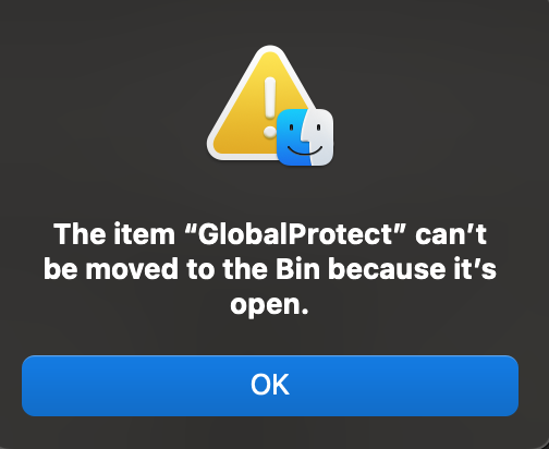

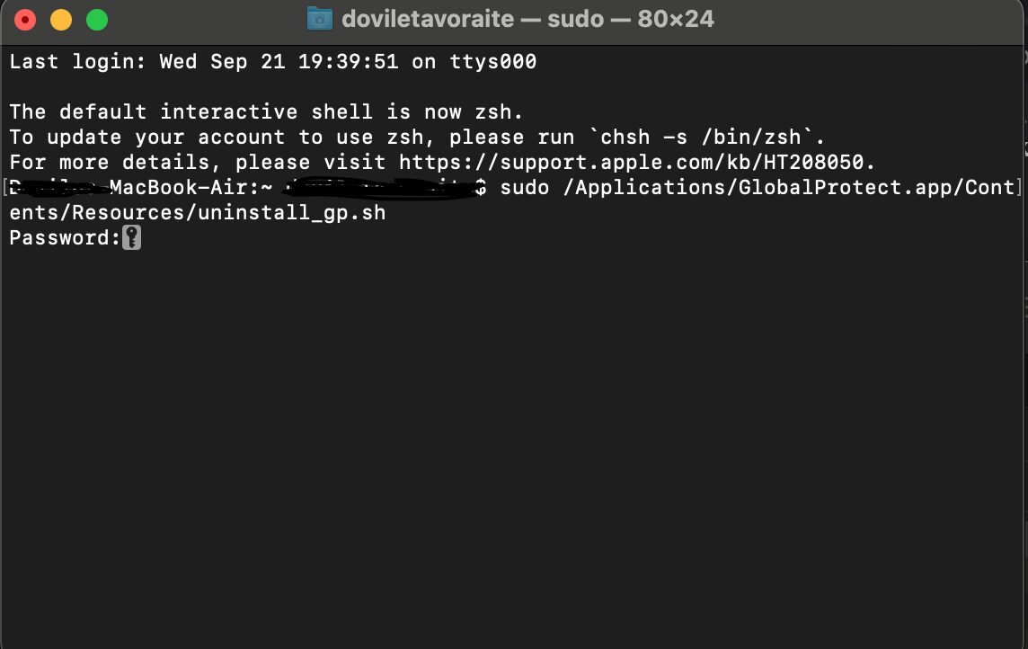

I cannot delete it because it says it's opened. I don't know how to close it as it only appears on the menu bar and there is no option like "force quit" or smth. Also, I don't know my password or anything. I tried deleting through terminal with this command: sudo /Applications/GlobalProtect.app/Contents/Resources/uninstall_gp.sh. but when it asks for my password I cannot type for some reason... any ideas?
Just type your password and press return. Terminal is designed not to show anything on screen when entering passwords. This would be your normal password for the computer but if you don't know that then you will have other problems and need to reset it which can get complicated.
ok, well still nothing happens...
