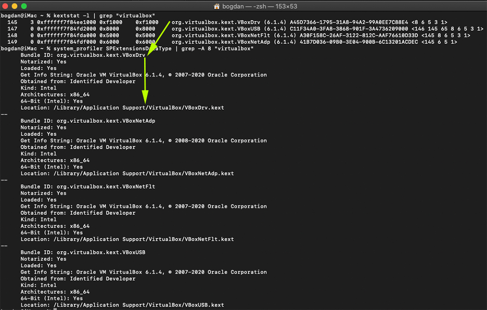

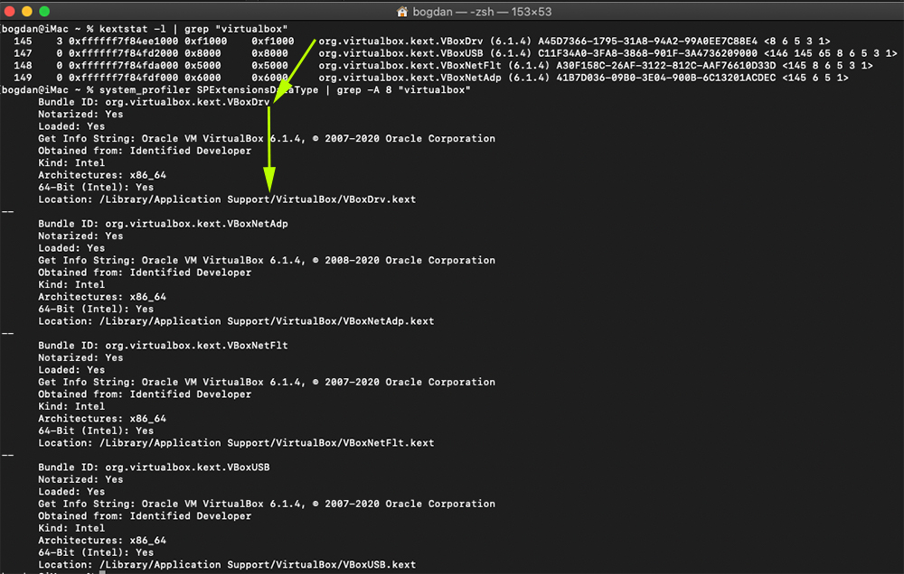

Do you know how a displayed kext name found in kextstat command is associated to the appropriate file ?
Thanks bogdanw.
Run
kextstat -l | grep "virtualbox"
to get only virtualbox kexts
and then run
system_profiler SPExtensionsDataType | grep -A 8 "virtualbox"
The Bundle ID's from the second are the names from the first, the location is the last line from each one.
