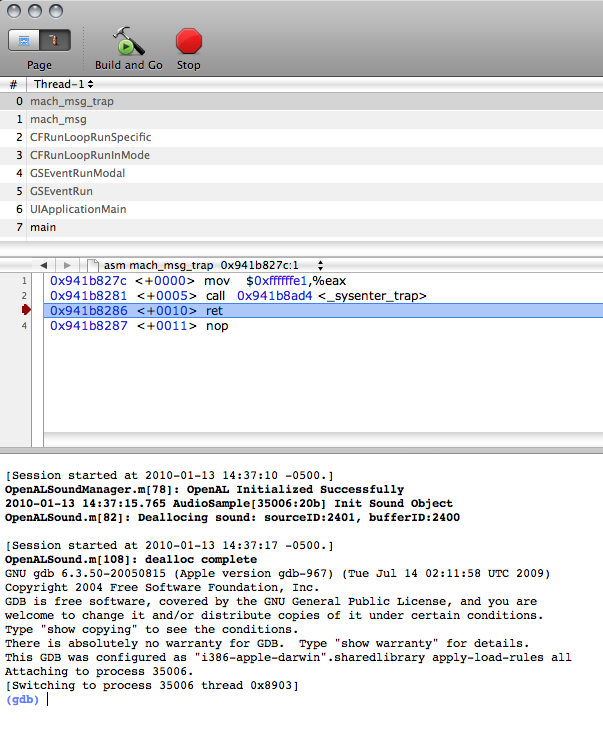

there doesn't seem to be one? it's a bizarre crash, since the app simply becomes non responsive. when that happens the console logs what you can see in the attached image. however, i have to manually quit the app (you can see the stop button is still enabled). after i quit the app, the following is displayed in the console:

while this is an iPhone project, i'm assuming the problem is with OpenAL so that's why i've posted the question in this forum.
