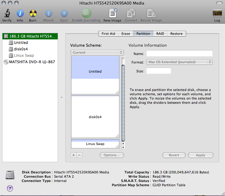

at this point in time, it might help if you take a screenshot of disk utility and show us the current arrangement of partitions?
ok, can do!
It's attached to this post. Thanks!
PS: I also cannot delete "Linux Swap".

You have used the minus sign under the partition table to delete the partition, right? Not "erase" which just reformats to a new filesystem.
Select partition, hit "minus".

yeah, that's what didn't work originally, and still doesn't work. I've hit the minus button and then left the computer running for a good two hours and it still says it is "preparing to erase volume" or whatever.
I installed Ubuntu as a dual boot primarily because whenever I installed my copy of vista, it said I had an error that meant my HD was corrupt (wmilib.sys or something like that file was "missing" and Vista was unable to load). I installed ubuntu without a problem but now I am willing to take a guess and say the reason that my computer won't let me delete my Ubuntu partition is quite possibly because the HD is corrupt.
Only problem is that I'm on vacation right now. If I wipe the HD, will I have to re-install Mas OS X? Because I don't have my installation disks with me and probably won't for another good week or two.
It does sound like you have some partition or file system level corruption.
Wait until you get back and boot from your OS X install disc. Run Disk Utility from the Utilities menu and try "verify" and "repair" on your HDD.
Then try and delete the partitions again.
