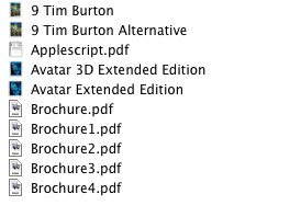

Try this
The script works with files not with an alias. The thingy with the little black arrow on it. I included a tumbnail how it looks like. The script runs slow. I have not tested it with a lot of files. The automator action runs faster. All your spotlight comments need to be unique. I you have put in a comment like Tahiti for all your holiday pictures from your last trip to Tahiti it won't work.

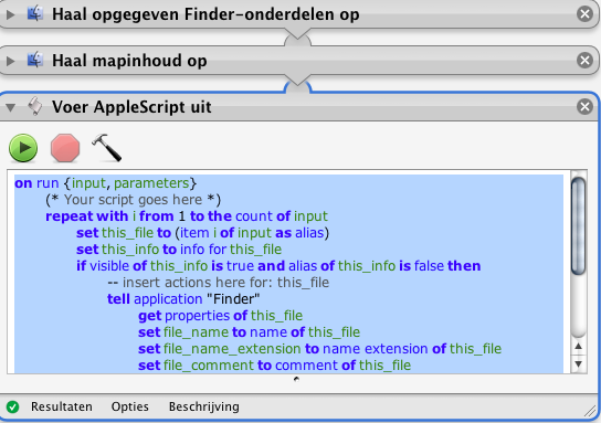

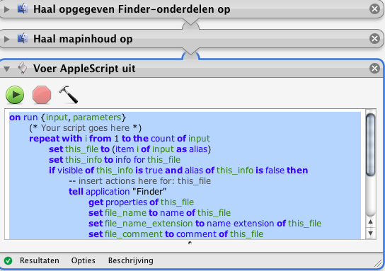

Automator :
Get Specified Finder Items --> A folder not files
Get Folder Contents
Run Applescript with this code inside it :
Code:
on run {input, parameters}
	(* Your script goes here *)
	repeat with i from 1 to the count of input
		set this_file to (item i of input as alias)
		set this_info to info for this_file
		if visible of this_info is true and alias of this_info is false then
			-- insert actions here for: this_file
			tell application "Finder"
				get properties of this_file
				set file_name to name of this_file
				set file_name_extension to name extension of this_file
			try
				set file_comment to comment of this_file
				if file_comment is not "" then
					set name of this_file to file_comment & "." & file_name_extension
				end if
			on error errMsg number errNum
				display dialog errMsg & " " & errNum giving up after 5
			end try
			end tell
		end if
	end repeat
	--	return input
end run

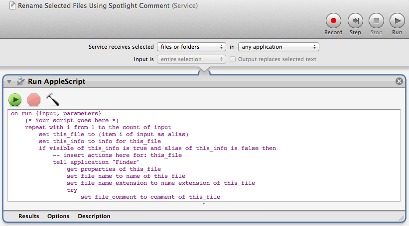

Thanks so much for your help.
How can I use the script you provided to create an automator service to allow me to right-click directly on the files I'd like to rename (not a folder containing the files), and then choose the option to "rename selected files using spotlight comment?
Thanks!
