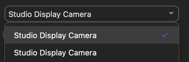

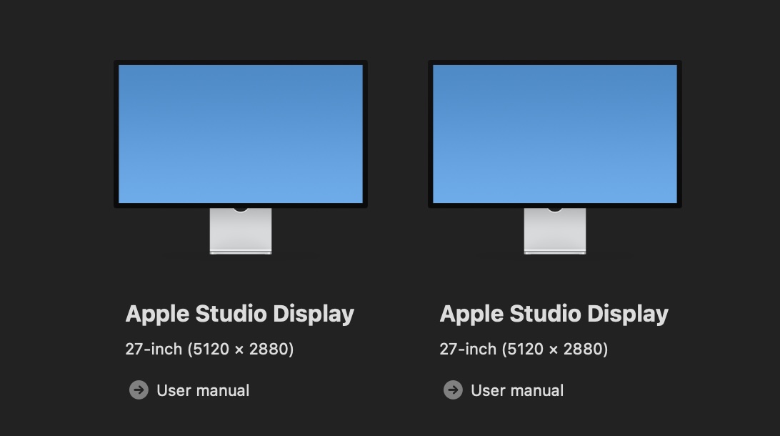

I currently use two side-by-side Studio Displays, which, unfortunately both get identified as "Studio Display Camera" when using different applications.
Is anyone aware of a way to rename either the displays or the display cameras to something different? (For example, Studio Display Left and Studio Display Right).
Thanks so much
