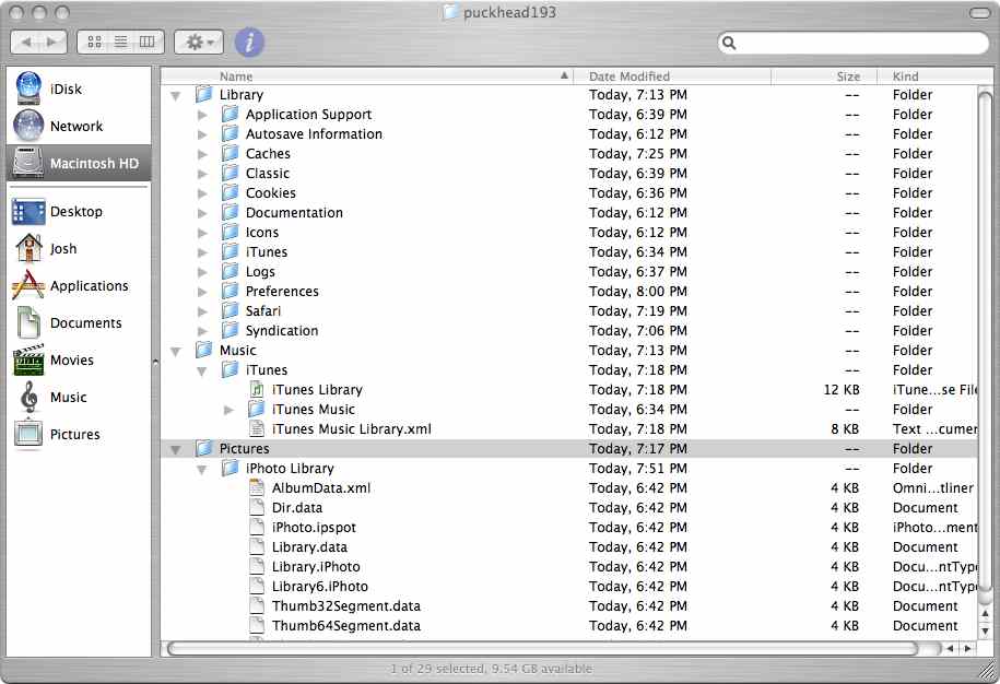

if i go to user folder and click my name my songs pictures etc all seem to be their... but their not in itunes/iphoto......
I see "Josh" which has the house picture thing... then their are two folders puckhead193 ( my dot mac account) and other folder shared...

yea, my folder i renamed seems to have my files in it, but the puckhead folder has all these files in it

He created a new account and i named it differently. Then delete my old account, but didn't delete immediately option. If you do it this way you get a disk image so you can always go back... From their he just dropped the new from the old and it was back to normal, except i have a new user account. THe genius also typed something in terminal to verify my data...
The only thing is i can't find where the iphoto library preference is. When i open it up i get a window saying my library could not be found and either create a new library or find library where to i go to find the file that saves my library...
Just move your iPhoto library back into your 'working' home folder's Pictures folder... If that doesn't work, pick 'Choose Library', then browse to the correct 'iPhoto Library' folder.
