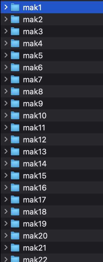

I've got a lot of files to rename for batch operations (turning png's into video files). I've been using finder to do 'batch rename' and it works great but it's laborious when there are lots of folders.
I use finder like this to turn folders full of:
Into: pic0001.png, pic0002.png etc. - ready for ffmpeg operations.

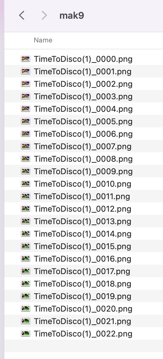

After a bunch of image generation, I now have loads of new folders like this full of png files:
Is there a way with terminal to rename all the files in one go? ... then I could rename the files and run ffmpeg inside each folder all in one go!

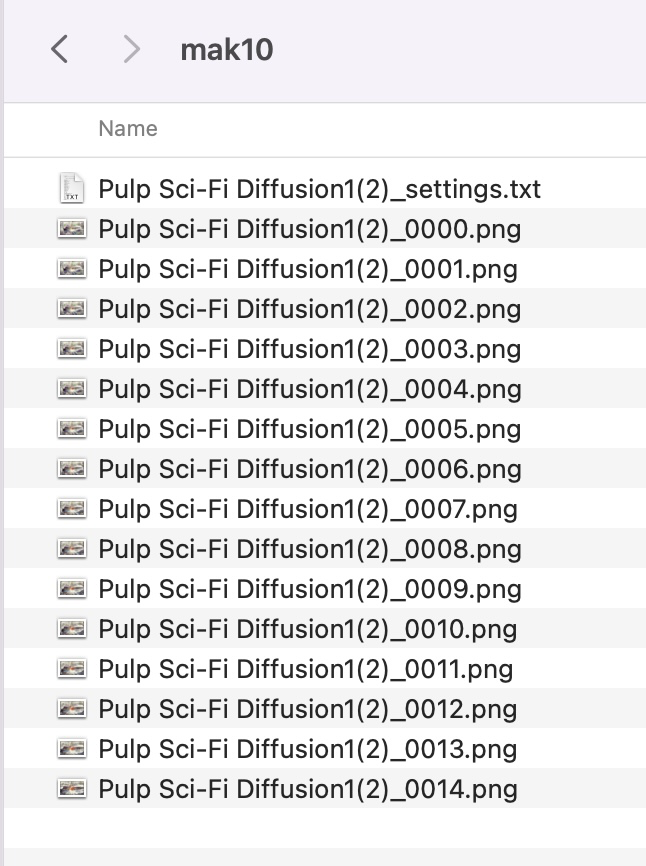

The files (unfortunately) have different names depending on the script that produced them, so I can't just run ffmpeg on them without changing the command each time which is laborious. Here's a couple of example contents:
So my ideal script would got through all folders (mak1, mak2, etc) and rename *.png as pic1.png, pic2.png, then run ffmpeg in that folder... oh and delete all the pngs! 🙂

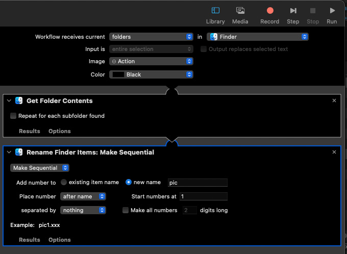

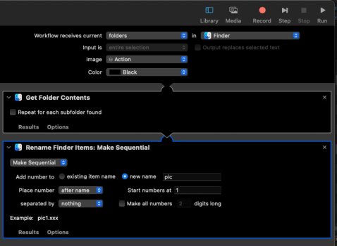

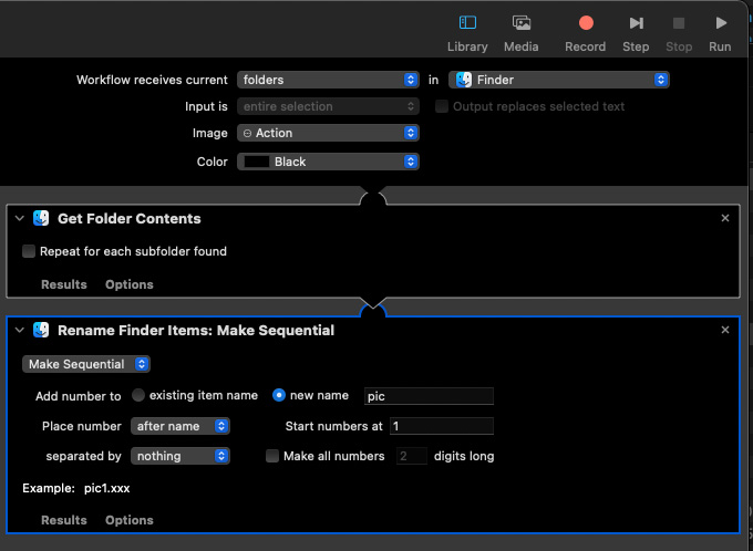

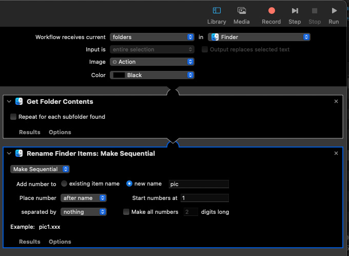

Tried this but the numbers don't start at 0000 in each folder (need this for ffmpeg)
QuickAction made with Automator
Agh this is so close again, but it doesn't restart numbering with each folder :/ ...
My ffmpeg command needs files that start with a low number. Maybe I could just tweak this somehow to work with any number?
