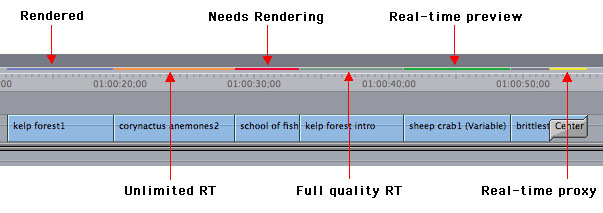

Curious. Does your timeline window show any red lines, like this? There are a number of sites and links which provide tutorials for FCP. Ken Stone tutorials have been helpful to many. http://www.kenstone.net/fcp_homepage/fcp_homepage_index.html
