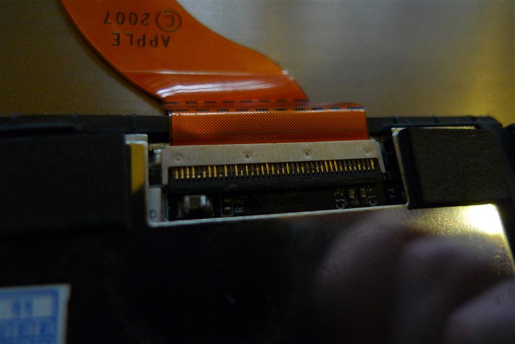

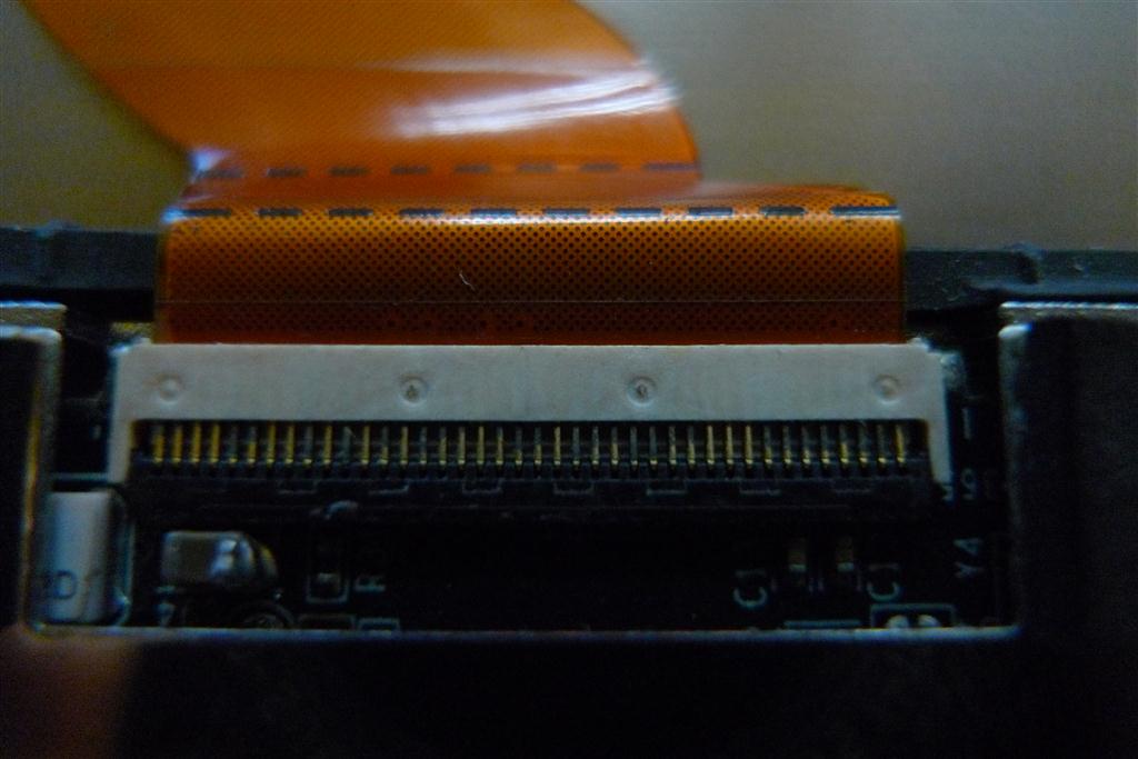

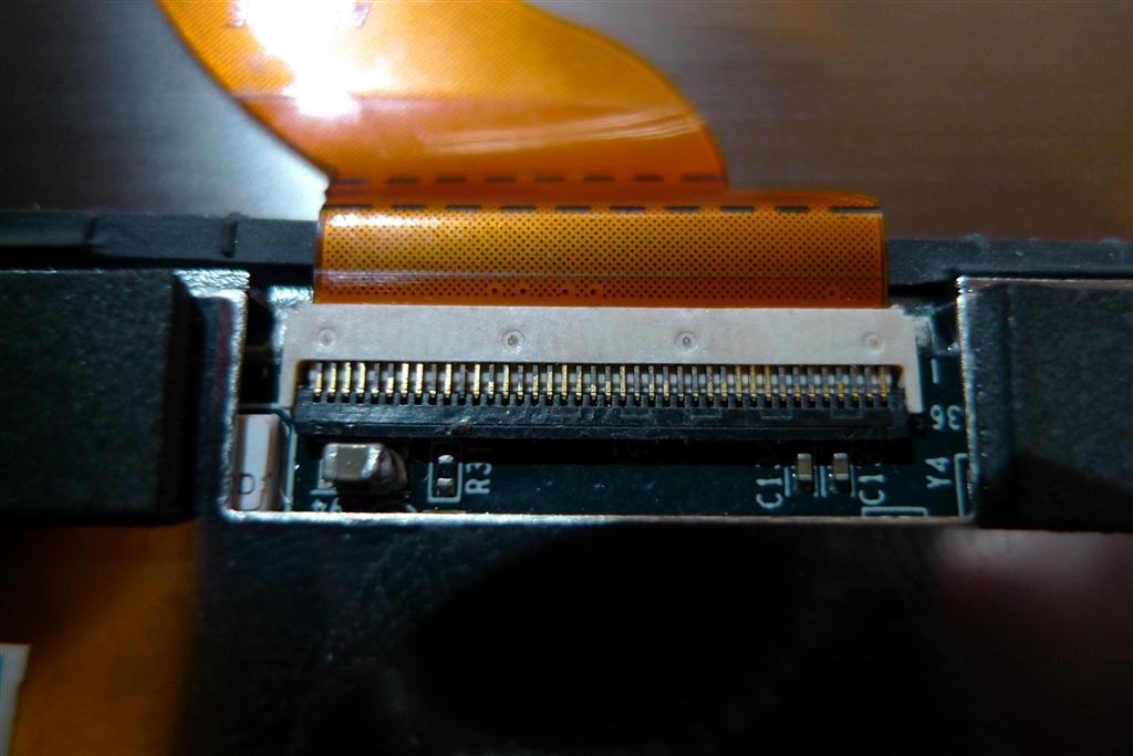

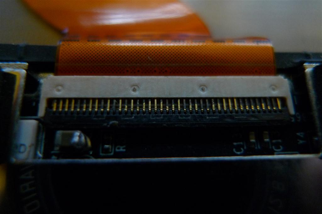

Hi Mate I too had the exactly the same problem with my 128 gb Renice drive that I installed about 5 weeks ago.
I would have to do a hard boot to unfreeze it.
funny enough it only ever happens main at home. I have an airport extreme and express extending the network.
At work I don't see this problem as much.

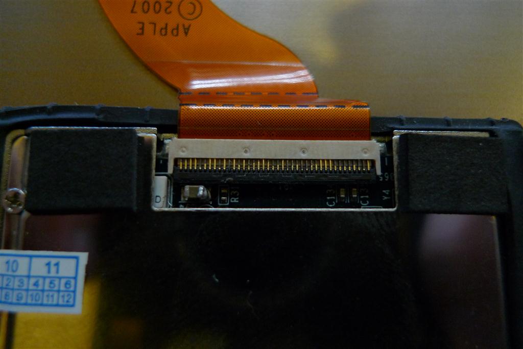

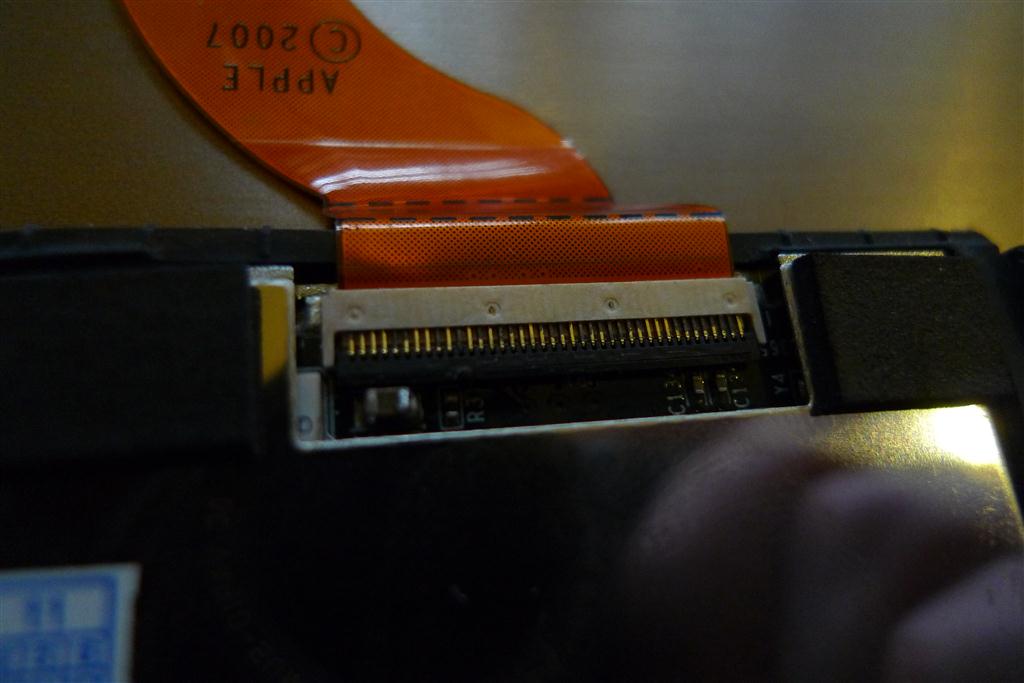

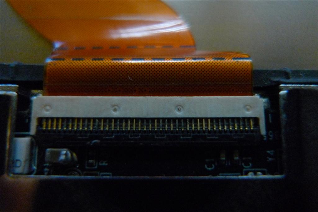

Any way it was getting annoying having to hard boot after putting the book to sleep almost every time at home. so i decided to double check the connection ribbon on the drive to ensure that it was properly in place.
At that point i noticed that the Gold female connector to the ribbon in the SDD drive was missing most of if gold coating!!!
I took several photos and have sent it away to Renice to see what they think. I am still awaiting their technical department to revert to me ( the initial inquiry has been replied to and informed me that it has been sent to the technical dept)
But as for now reinserting the ribbon looks to have fixed my freezing issues for now ( been almost a week and no freezes)
here are some pics of the pins....

reinstalling the ribbon looks to have fixed my problem. no more freezing on wake issues face now fore about 2 weeks. Give it a try.
