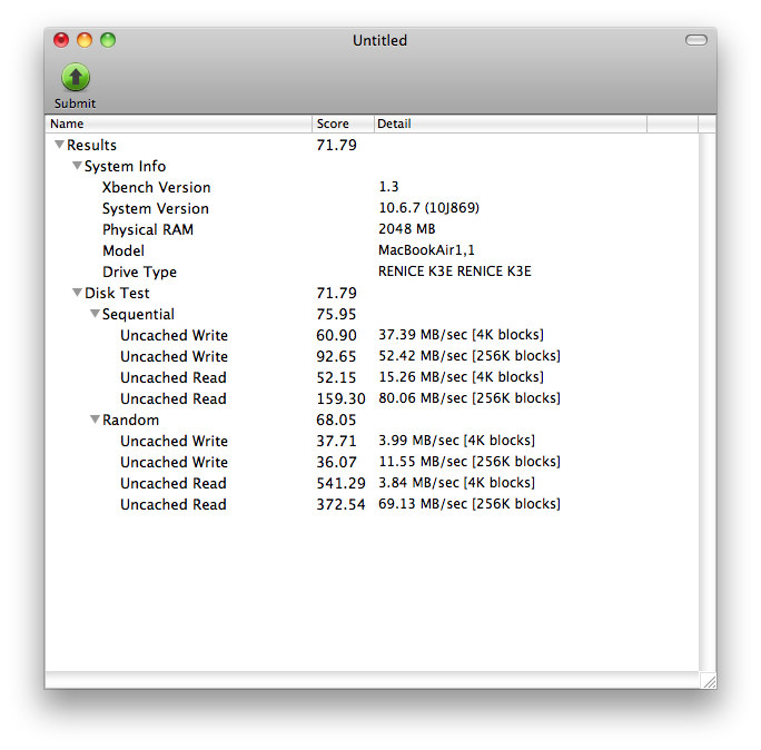

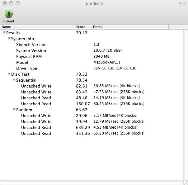

Hi,
I made this upgrade, too. I am a little confused about the benchmarks, that have been posted here.
First: spriters xbench results:
Samsung HDD: 2x.xx
RENICE K3E SSD: 11x.xx
Compared to my xbench results:
Samsung HDD: 4x.xx
RENICE K3E SSD: 7x.xx
Then the xbench result transmitted by shtodd
So it looks like my SSD is a much slower than spriters. Did I miss s.th. while I installed it?
My procedure:
-Installed the SSD in the RENICE enclosure
-Formatted to MacOS Extended (Journaled) and a GUID partition table
-Removed it from the enclosure
-Installed in my MBA Rev.A
-Install SnowLeopard
I read some hints in case of trouble:
-resetting PRAM and VRAM
-set hibernate mode to 0
What do these actions do? Will this speed up the system?
Greetings from Germany
Johannes
PS: Sorry for my bad english ;)
EDIT:
Here are my results:
After testing nearly 2 Days, I am suprised. The every day performance is very nice. Its faster and equals the described speed of other users using the K3E. Safari & Mail 1 Bounce, Word less than 10sec, boot less than 30 sec.
So I wonder what the problem is with the benchmark. No one?
